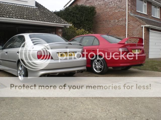

Where you get rear bumper and skirts from? Very nice. I seen some on ebay and there only 200 which seems a bit cheap?? I really want to get mine lowered to!!
I was talking to my mate lastnight and he don't think my cars a sport as its not colour coded or got a lil spoiler like yours! That right??
my old one wasn't a sport either mate. Was a 2.0. The Sports are a 1.8 and are hatchbacks. They come with white dials too. That's usually how you can tell them apart.
Are there any pics of yours on the site? If not get some up and someone will soon tell you what's what.
As for the kit it cam from the M99 site. It was a good looking car, and certaintly turned heads.
