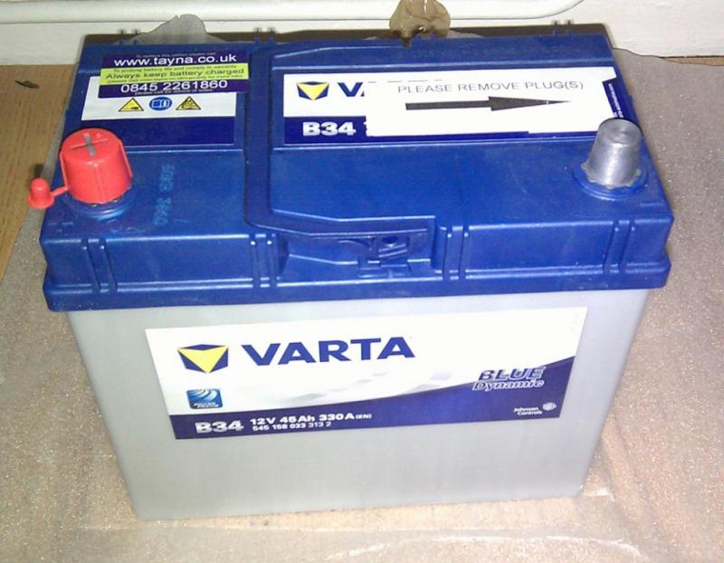

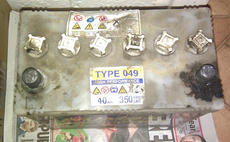

What rating should the battery be for the 2.4? I took mine out last night to give it a proper charge (the new one is going in today) and it's only 40Ah!! The new one is 45Ah but even that seems too small TBH.
This is the one I got - http://www.tayna.co.uk/Type-049-Varta-Asia-Car-Battery-P3207.html
Used the code PRO2010 for 5% off :)

To Clarify - My Current Battery is a Honda Branded one with the code 31500-st3-100 he.

I eventually ordered the Varta B34 pictured above. Received it yesterday, but haven't had chance to fit it yet. Typically, I leave for work today and the damn car won't start :mad: . Sods law i guess.
Anyway, i'll swap it over tonight and see how it does.
Thanks again for the suggestions.
Tom
