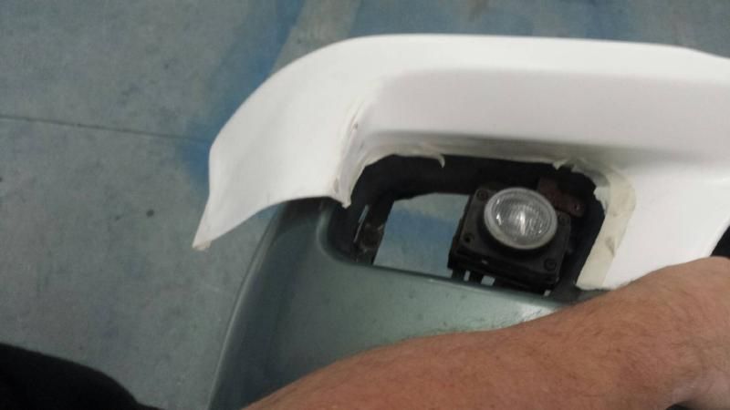

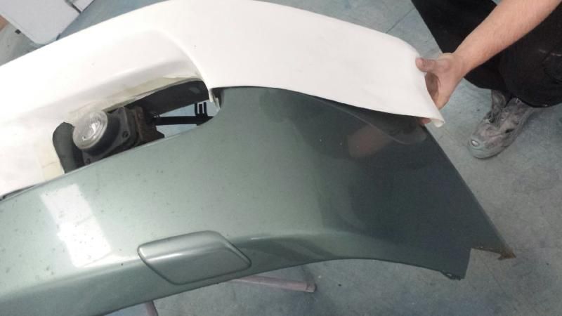

The guys in the bodyshop have sent me these photos of how the spoiler is lining up at the moment and as you can see, the shape at the ends just seems all wrong and I want to double check whether this is due to the mould being rubbish or is there an actual difference in shape in those areas between the diesel and petrol bumpers?

After having another conversation with the guys at the bodyshop we've agreed to not bother with this spoiler, they would be able to get it to fit okay around the sides but the gap you can see around the fog light hole (as circled below) would need cutting and remoulding, which would be too much work at the moment.
Can anyone confirm for me though where this bit is due to the mould be off or is there a fundamental difference in this area between the two bumpers?
That's a poor quality mould mate. The lip should fit
