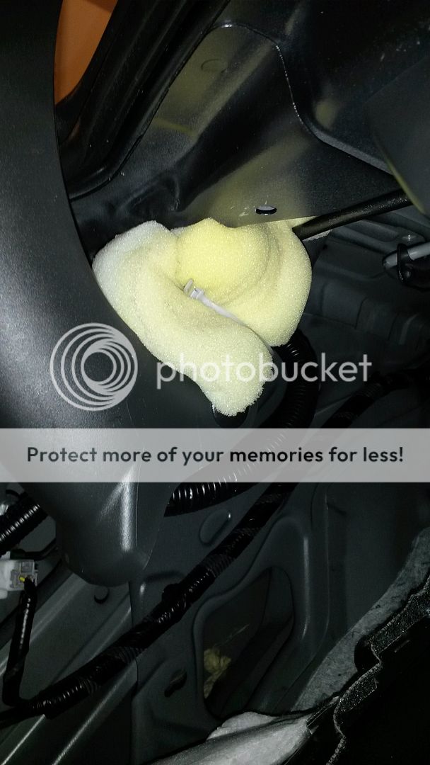

Just ordered som springs. I will try to make some foam by the boot lever so it will stop more smoothly.
But very nice mod, looking forward for doing this my self.
just fitted the springs. i put some foam in there to, so it dont bounce to much.
