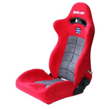

I found a place in Nottinghamshire, GSM Performance, not so far from me, made an appointment and I went to try out all their seats, the sales person - Garreth, was on point. I really liked the Recaro Cross Sportster CS Reclining Sport Seat but at £1000 per seat it was out of my budget
Off all the other seats I tried, the buddy club seats we my next favourite, these were supportive, comfort and position is excellent, and decided to to get these, at £499 each, they were just in my budget
http://www.sportseats4u.co.uk/buddy-club-red-sports-recliner-seat/prod_2276.html
