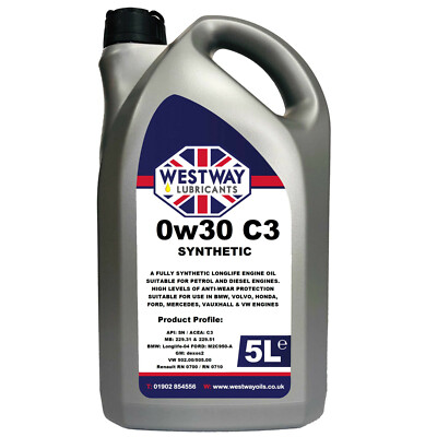

I've got 20 liters to burn, £180 total with import tax and shipping, but if I were to source it locally I'd be paying £45 a liter for big brand stuff like mobil 1
