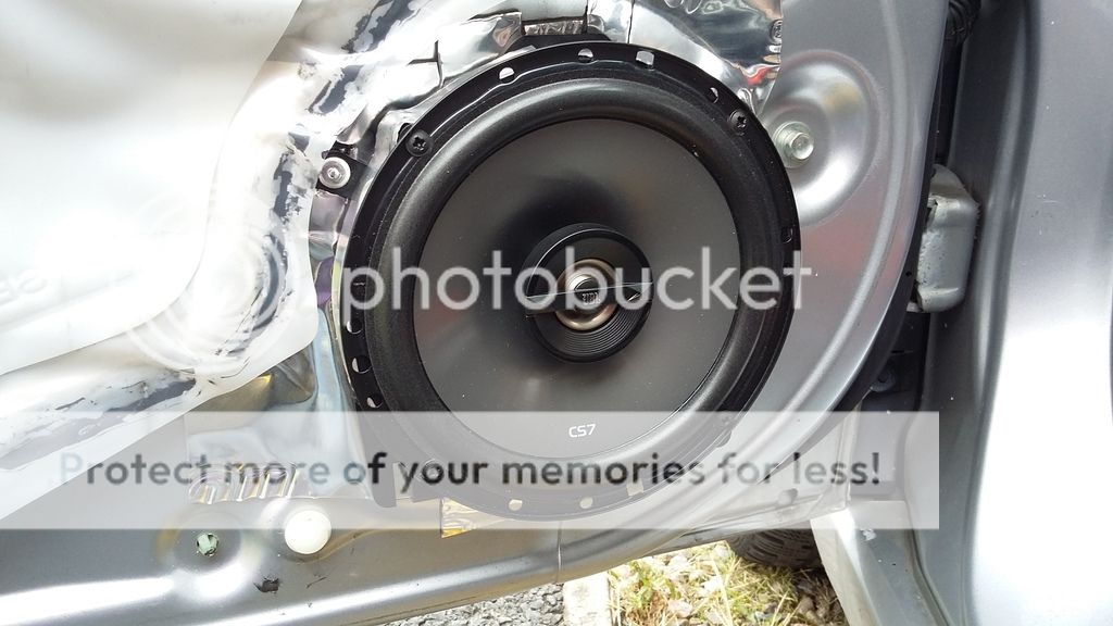

I know this has been covered before but I started into my speaker upgrade this evening so I thought I'd document it as I went.
I couldn't source speaker adaptor pods anywhere in the UK so I picked these up on the US site.  See details below
https://www.amazon.c...speaker adapter
They are listed for a Honda Ridgeline but fit perfectly
To save butchering the original wiring I also got the wiring adaptors
https://www.amazon.c...speaker adaptor

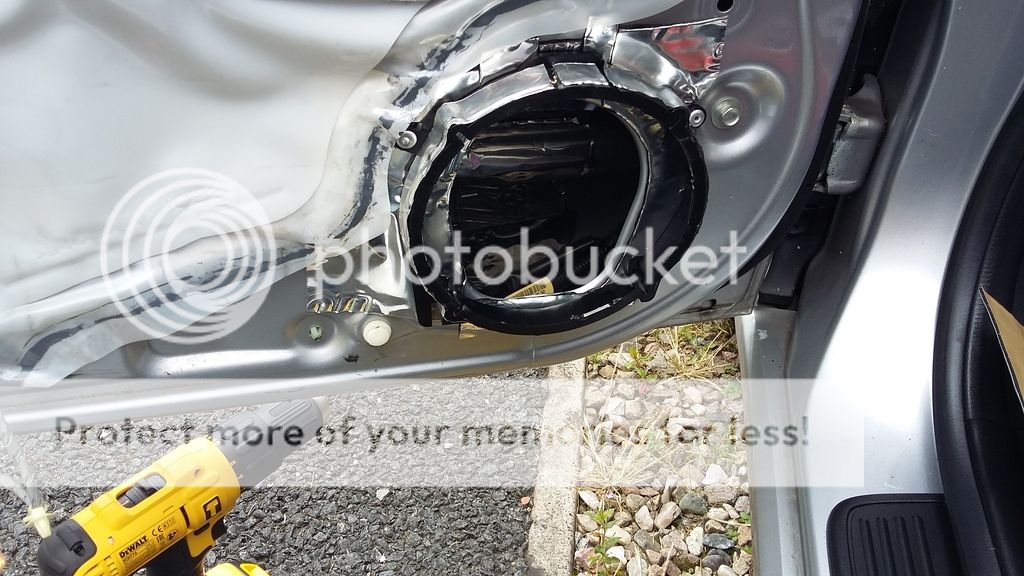

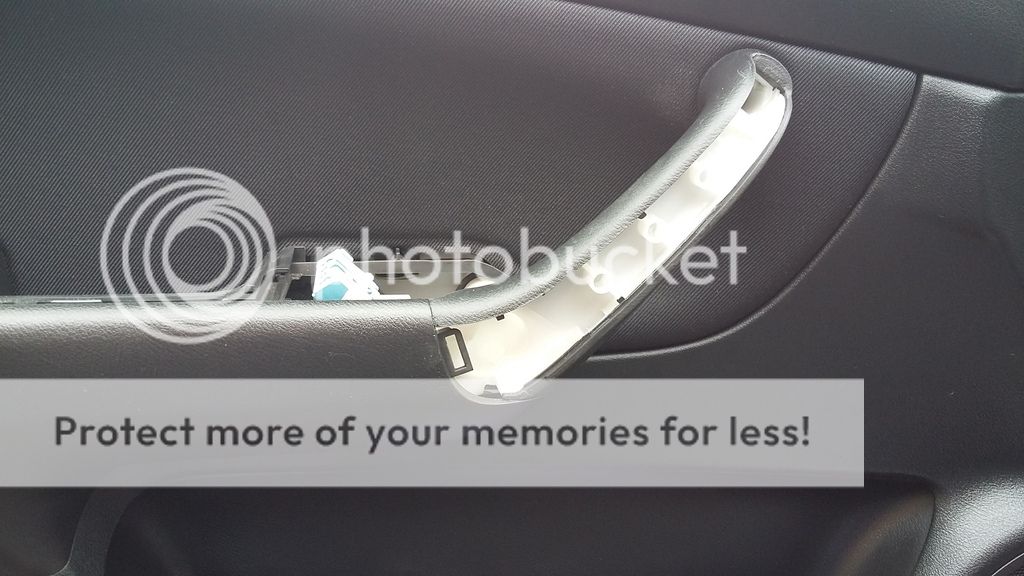

1) Remove door cards - I use a cheap set of trim tools I picked up on Amazon to do any work around plastics.  First remove the plastic trim covering the wing mirror mount
pry off the cover behind the interior door handle, undo screws
There is another screw under the rubber trim at the bottom of the pull handle on the door card, pry his up and remove
At this point you can remove the door card, I used a wide trim tool pryed round the edges of the door card.  Release the bulb for the puddle light in he door and the card will swing out of your way and let you work.

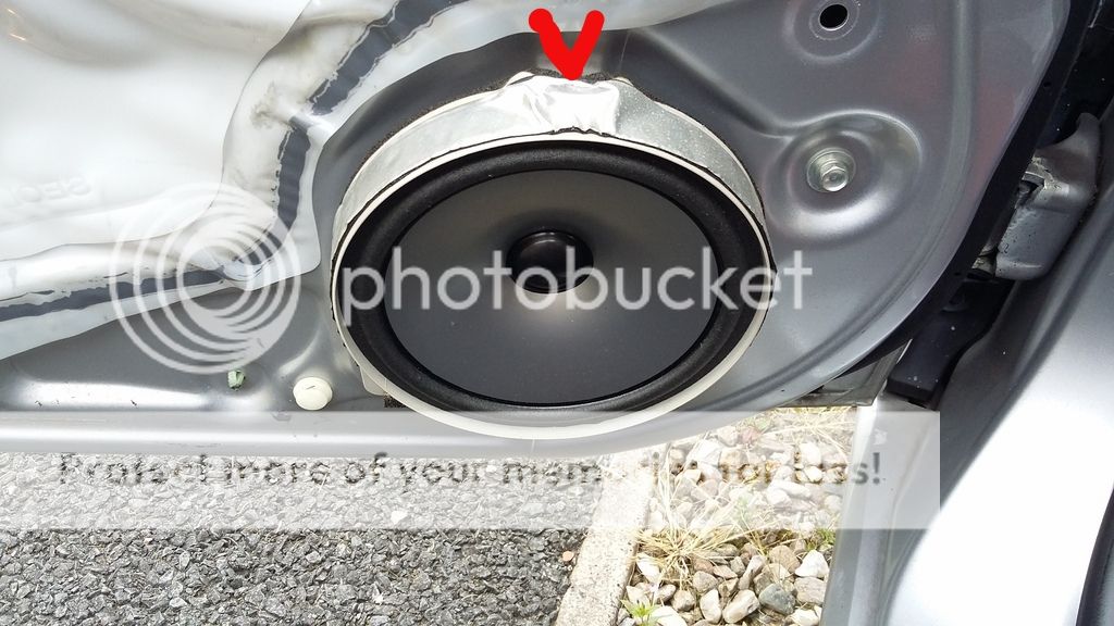

The original speaker can be removed by releasing the spring clip at the top of the speaker and lifting the unit out of the door.
I thought I would take the opportunity to smother the front doors with sound deadening so covered he inside of the door skins and the frame with Dynamat type material
This is well worth doing as it has even deadened down the sound of the doors closing, sounds very Germanic now.
I was running out of light on the build up so I'll finish photos when I do the left side tomorrow morning

Well worth doing, the standard unit actually produces a pretty good sound quality with better speakers. Make sure you swap the 6x9's too!
I swapped out the 9x9s earlier this week, it was quite a handy job.  I got a set of 3 ways which I think are a bit tall for the standard grills and are fouling a little.  It will be an easy fix though, cut the centre out of the speaker grill and retrim with acoustic cloth
The new speakers do make a massive difference, no distortion at all

There are two screws hidden behind he silver trim on the passenger door trim handle
As with the driver side, also remove the screws behind the lock handle in in the trough behind the electric window switch

Speaker is removed by pressing down on the spring clip (highlighted) and prying out

As with the drivers side I dynamatted the door cavity and the door frame where the speaker mounts attach.  With his done, I fitted the speaker adaptors, marked up the holes to secure, drilled and riveted in place
Speakers connected and screwed into the frames.  Good move at this stage is to test they work before reassembling the door trim
