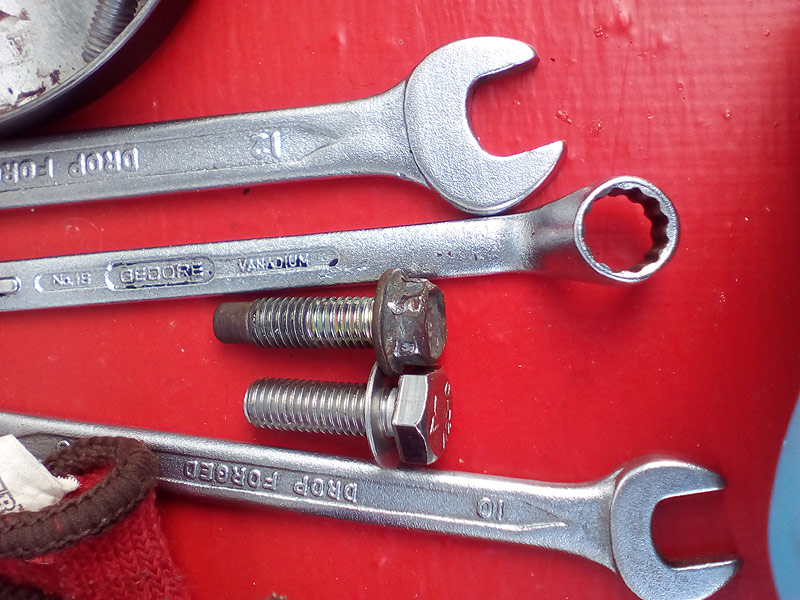

This turned out to be quite easy to release with a good bit of elbow grease to break the torque.
The front bolt proved to be a bit of a nightmare with the spanner slipping off rounding the head
so to avoid using the vice-grip I turned to the 12mm socket with 1 arm each side of the expansion
tank, the left hand holding the socket on the bolt head the the right to lever open I was able to
break the torque - Result.

The refitting was extremely straight forward. I used a stainless bolt to replace the damaged one from the removal.
