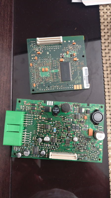

When trying to configure the bluetooth my car, when I arrive in the part when it tries searching for the phone it isn't finding the phone however not pulling more than usual from battery when on standby, usual problem.
I have dismanteled the bluetooth, any idea which board could be the issue ?
Seems to be working again, used the oven trick, heated for 190-200 deg for 12mins. Fingers crossed easy fix :)
