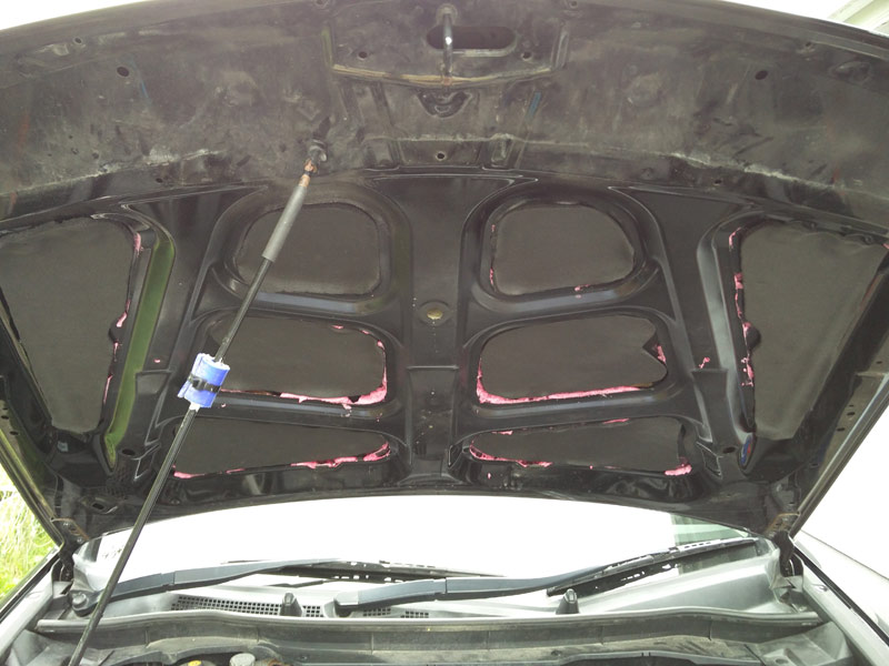

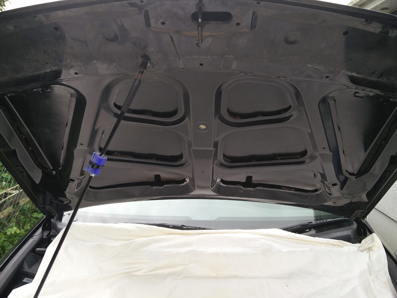

I removed this today and noticed the bonnet outer skin has come away from the
subframe. the images show the glue spots have ripped away leaving about an inch
seperating the two . . . strange because the bonnet looks to be aligned properly :wacko:

Finally got around to repairing the underside of the bonnet.
Fire resistant expanding foam sprayed intermittently to allow for proper expansion
Heat and water resistant self adhesive closed cell foam for between the webs
Heat resistant paint to rejuvenate the mat
And some new plastic fasteners to fix the mat to the under side of the bonnet
Actually there isnt any difference that im aware of. The mat was there to begin with so the task was to stop the bonnet from flexing while washing and polishing and risk denting
