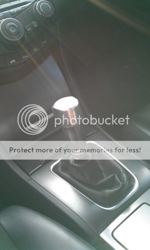

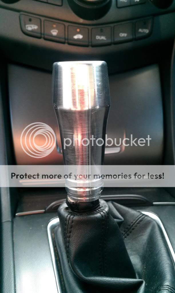

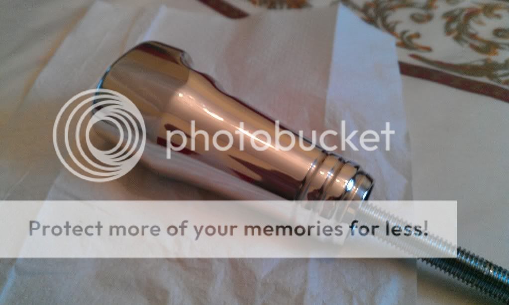

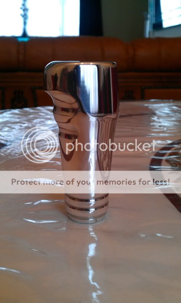

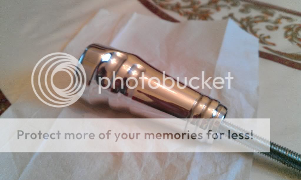

HEY GUYS,(been away for a while,due to exams etc) been looking to change the gear knob in the car for a while, so the search went for one of my all time favourites, the Vti-S metal gear knob(now quite rare too)so mangaed to source a vti-s being broken down for spares and repairs and they STILL had the gear knob(having tried ebay,gumtree, and recieving qoutes for 50.00+ :o ) for 20.00 inc postage:
here it is:
Posted Image
Posted Image
Posted Image
in the car:
Posted Image
Posted Image
Posted Image
i think it looks pretty good(rather than cheap ebay ones), but anyone have any ideas where i can get it polished as it does have scratches????would look PERFECT then. opinions guys???

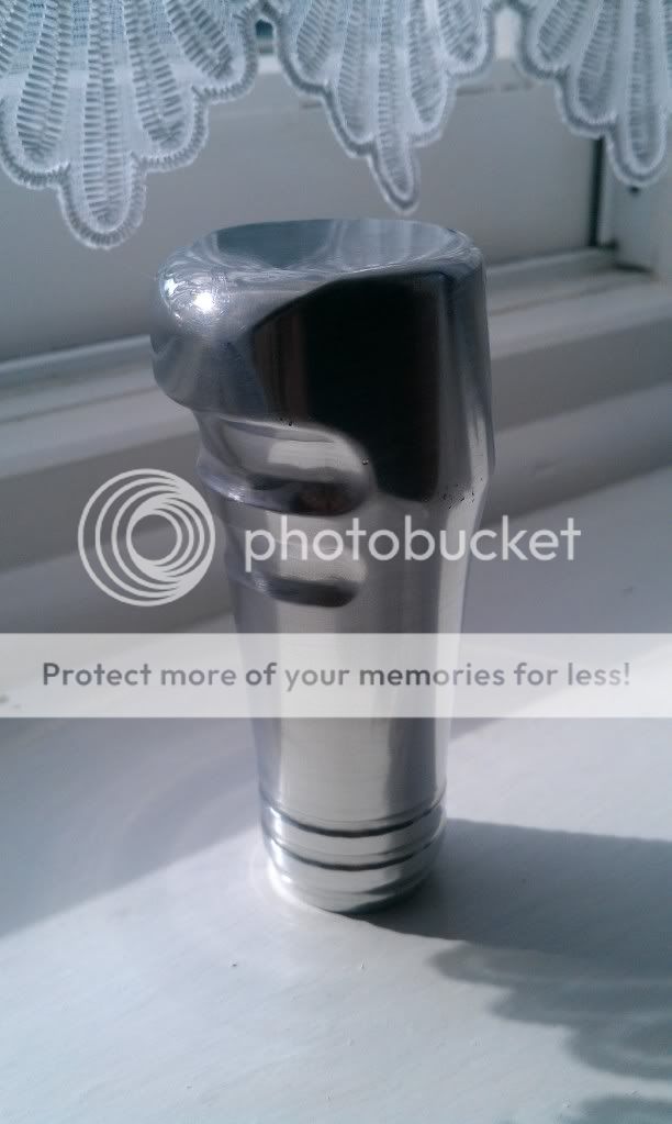

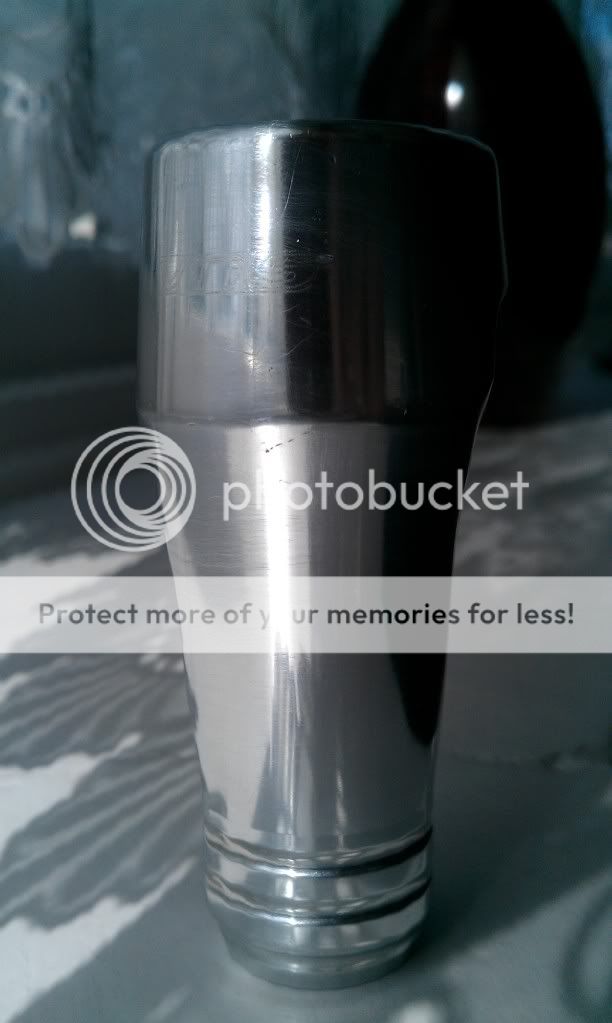

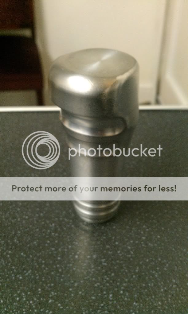

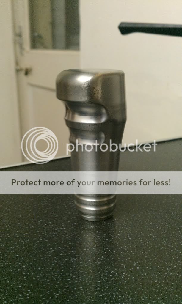

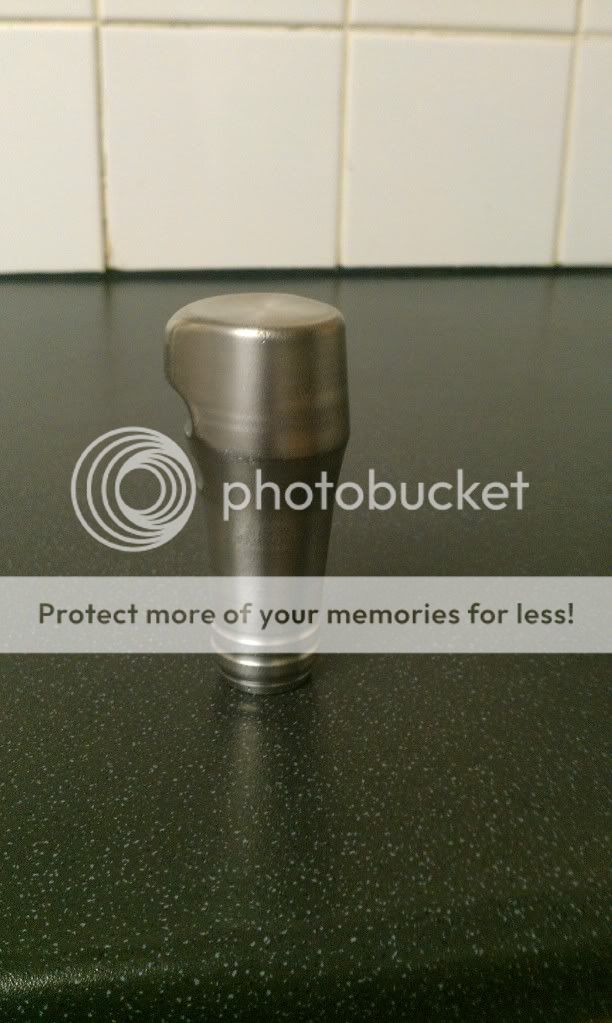

ok guys (kinda answering my own question here,lol)iv got cracking on with it(after reading upon the civic site got me rearing to have a go) i managed to get a bolt with attched to the bottom on the gear knob,(with the head cut off) and placed it in a drill. Taking the advise of the site and ROAD DETECTIVE, at a slow speed i spun the gear knob in the cotton wool(wearing gloves,as IT DOES GET HOT :o :o ) and here is my results:
Posted Image
Posted Image
Posted Image
Posted Image
as you can tell the top part of the gear knob was the most difficult with the wool,as its not fully circular, so some parts of the grip will have to be done by hand,so far i think its going well, :unsure: , but i will get some autosol from halfords tommorow, and get on polishing(im guessing alot elbow grease is going to be needed...lol)but stilll not sure if i should have used any sand paper(wet and dry 400,600,800,1000,....guys???

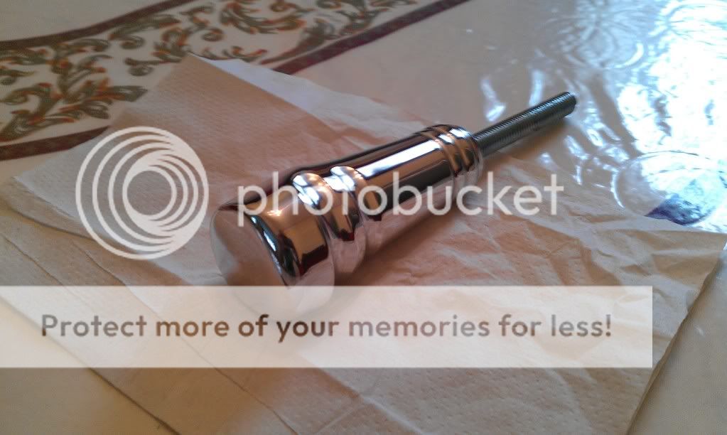

Well buddy been hard at work today,I did get some 2000 wet and dry,I still had the gear knob on the drill and just spun it,while I worked about 2sheets of halfords wet and dry,this did get it very smooth and a sort of semi shine...I then applied the autosol to a microfibre cloth,and spun the gear knob again in the drill whilebcloth was placed over top,done this 3times and here is the results:
Posted Image
Posted Image
Posted Image
Posted Image
Posted Image
and im chuffed with the results....i think it was well worth the effort,and didnt have to send it off either... B)
let me know what you think guys.....
