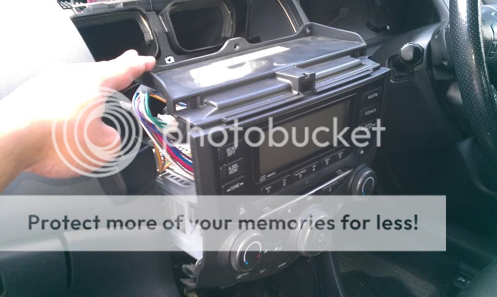

right after going back and forth from audio shops looking for audio iso connector, i gave in and went to halfords, picked one up for 14.00, also brought some fixing brackets to modify the facia plate. This were the fun began,no one had a clue about the oem audio system, weather the stereo had to have power to control ac/heating, so i had to find out(and had to get to the back stereo to take out the iso connector from the oem unit any way),
so first was to take out the two screws which holds the oem unit(this is inside the cubby hole area)
secondly i had to lift the top cover(the bit with hazard light)this just lifts up(thanks faddy for your help bud..lol)
then had to remove the three screws which holds the stereo unit in place..
with a bit of tug and pull lolthe unit just slips out...
i took out the iso lead from behind the stereo,and pluged the other end of my stereo iso lead in(simples..lol), THE UNIT CAME TO LIFE :D , SOOO i also tried the heating and the ac controls.....GREAT THEY WORK TOO... :D :D :D , although there was no display on the oem unit of the heating controls,i could attach(piggyback)of the iso connector and add another lead but since im not too fussed about the display,i didnt bother, so guys if you are trying to to connect an iso lead, my founding is that the heating/ac still function(but the display does not)..although this can be easily over come(if your bothered..lol)the oem stereo however has does not function at all.

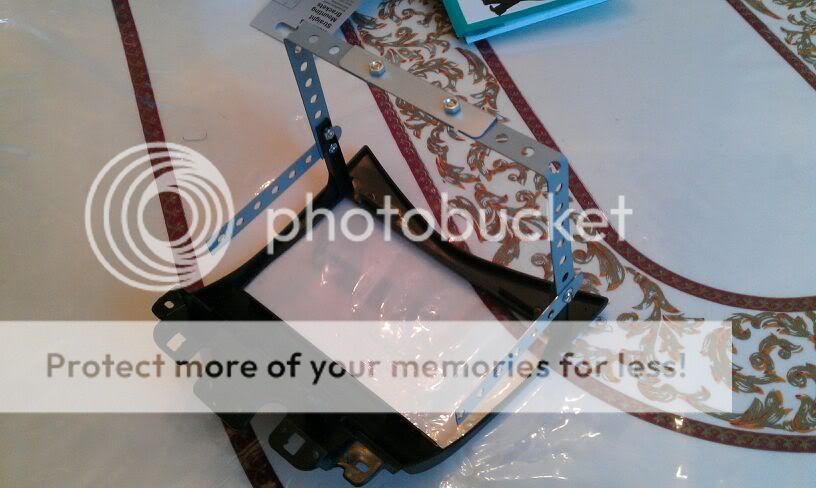

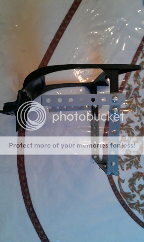

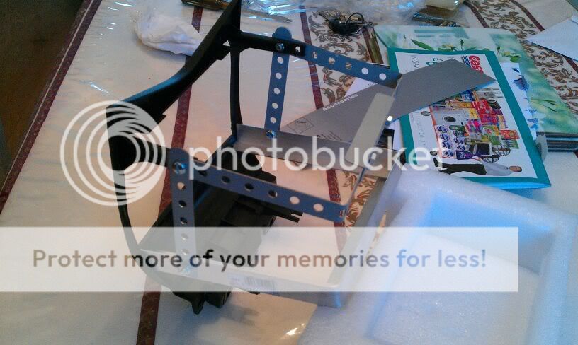

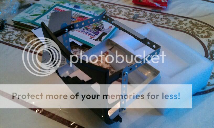

so it comes down to fabricating the fascia, the original problem being is that i can not put a cage around the system(as the facia is too small)and the weight of the double din pulls the fascia plate inwards, soooo

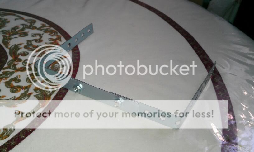

i brought some fixing brackets from halford and attached it to the bracket supplied with the stereo(was attached using some bolts and nuts...as you can tell i had to bend the fixing brackets around the stereo to get the right angle..
i then drilled 2 small holes in the side of the facia so i could attach the custom bracket which i just made as well as two diagonal strips of fixing brackets...i also bolted these into place

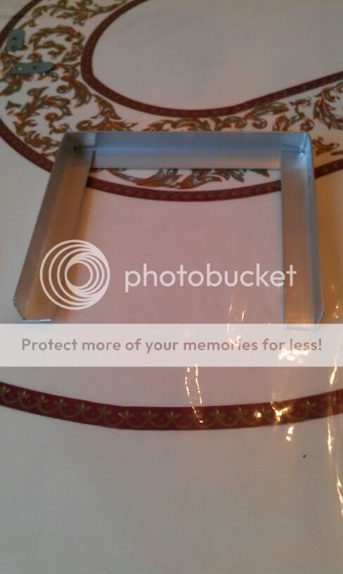

i then got a thin aluminium strip(the corner strips available from b&Q for 4quid)and made a similar bracket again folding to the shape of the stereo(but this will fit at the bottom...
i attached the bottom aluminium folded strip to the top,using the horizontal fixing brackets(again using bolts)
this has made the fascia plate more steady and will support the stereo since im not installing a cage)

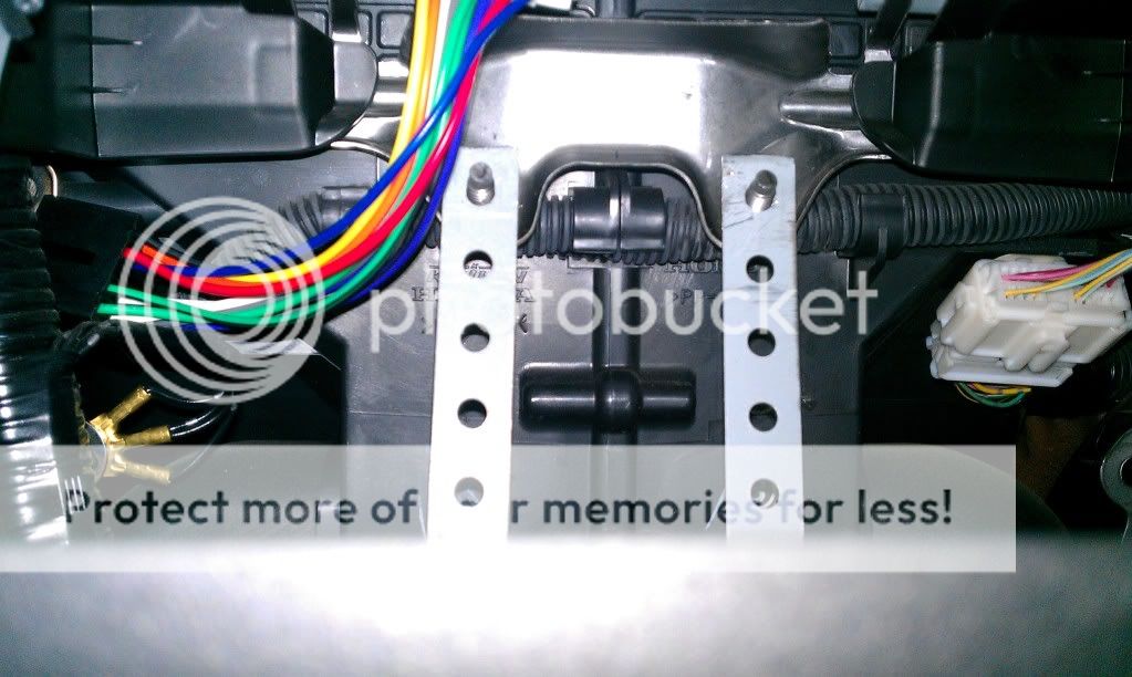

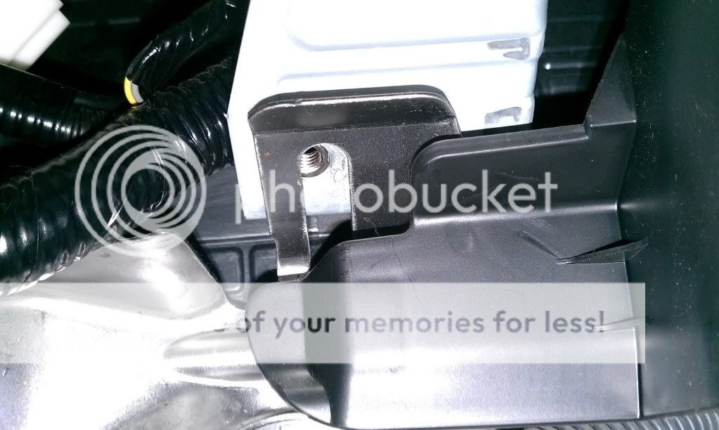

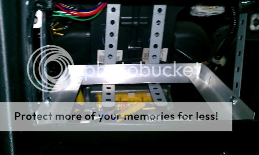

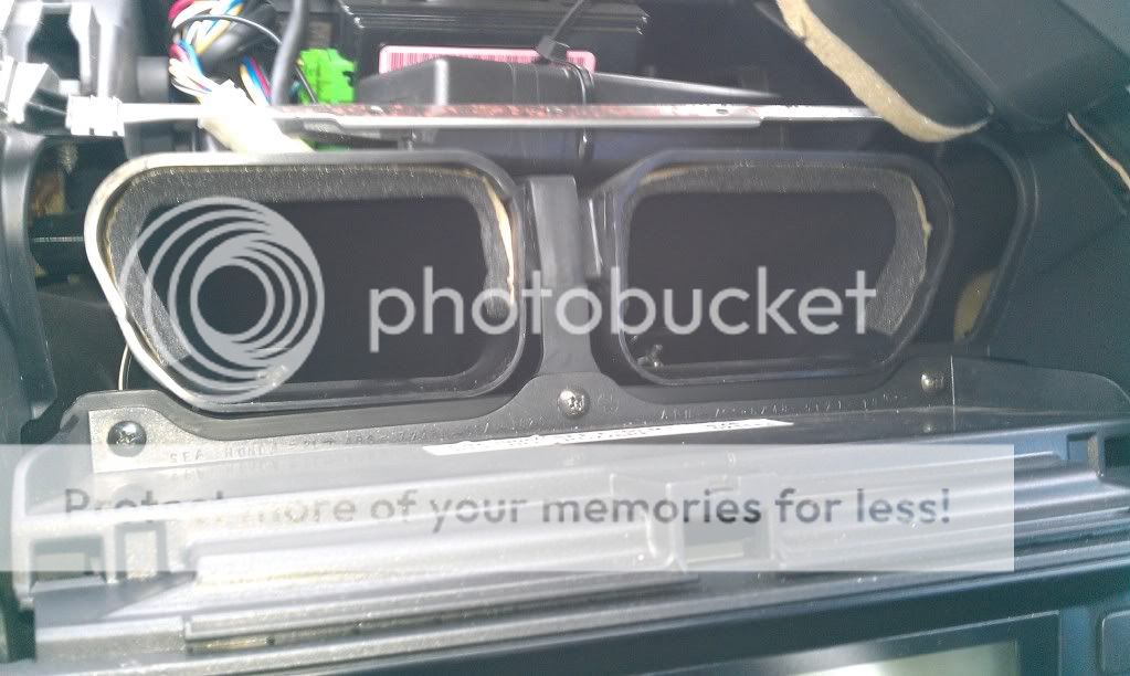

so in the car is where i had a genius moment(does not happen very often) i noticed at the back of the cubby hole there were two bolts which could come in usefull, so instead of using the top bracket(i know one step back...lol)im going to use the bolts,this will guarantee the facia being more steady and robust.
these are the two bolts:
i have attached two bent fixing brackets and will bolt these into place,
as you can now tell the back, bottom part of facia(the fabricated aluminium piece)will now be held up by the the two fixing brackets attached to the two exsisting bolts of the car..
also the horizontal fixing brackets have been attached to the inside of the cubby hole using bolts, this had made the front of the fascia very strong and stops it from falling back(you can just see it in the pic)
and this is the end result of the fabricated fascia plus supports..lol

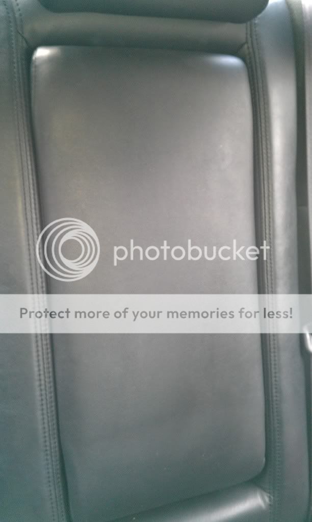

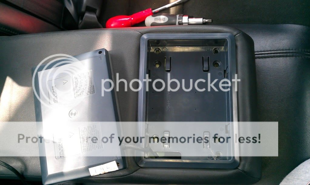

right as im still waiting for the tv antenna, i thought i might as well start the rear arm rest install,i firstly thought i would have to take out the whole armrest to work on it, but as i started to look around this seemed quite difficult as i had no idea to get the rear armrest out(even unzipped the rear seats to see if i could get to it but still no joy)so it i began work without taking it out:

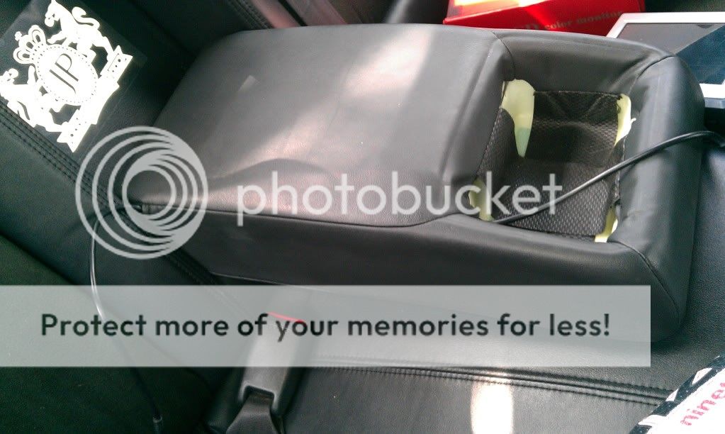

first was to get the cup holder plastic section out(this is were my screen will go)this just simply unclipped and lifted out:
you should then be looking at some thing like this, this cut out section is the armrest is exactly the same size as my screen holder:

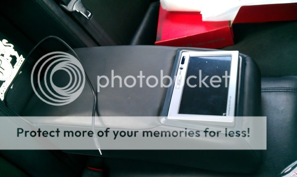

i then wired the connection for the screen along the side of the armrest(inside the leather)which will then go either under the seats or through the into the boot:
right next was to fit the screen holder into place(please note i didnt screw it down as this is trial fitting stage),as you can tell its fits exactly, as the cup holders did.

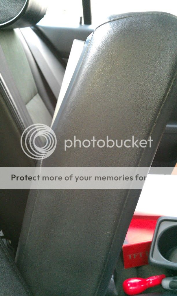

next the screen will go in at at a slight tilt(this is obviously for easy viewing purpose):

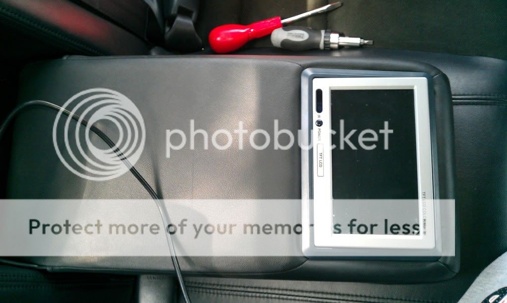

another top view:
this is the side image of the screen tilt:
and finally checked to see if the armrest closed properly:
nice and flush
remember guys this was just a trial fit! i will have to fabricate some brackets so the screen holder will be more secure and sturdy,this will then be wired to the double din head unit at the front,i think its a better and safer solution than having headrest screens(as thieves are keen for stuff like this)and since the armrest folds back into place it conceals the screen,away from prying eyes. so coming along nicely... B)
