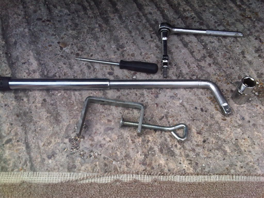

Tools required:
1. Trolly Jack (or Honda Jack)
2. Wheel brace + 19mm Socket
3. Prying tool or screw driver
4. 7mm Hex bit or allen key
5. Brake piston pushing tool
6. Copper grease
7. New brake pads!
Sure most of the above is hidden in everyones tool box...... well except the 7mm allen key. I had to nip to halfords to buy a 7mm hex bit for the ratchet.

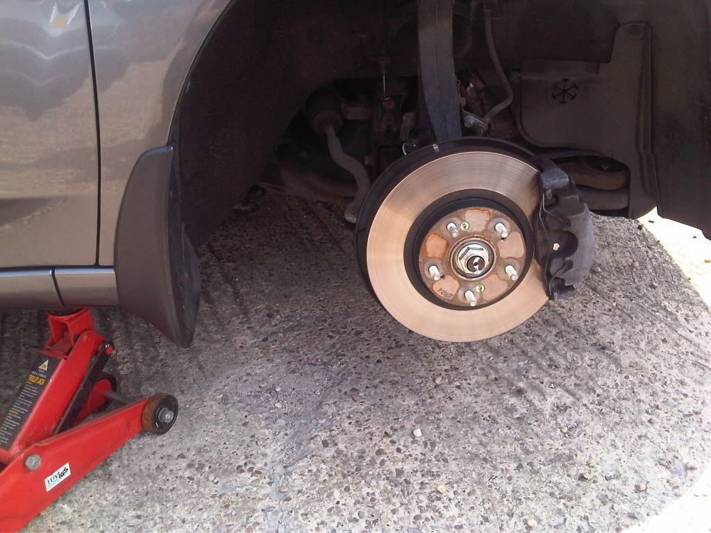

Usual start, make vehicle safe etc etc and get that wheel off.

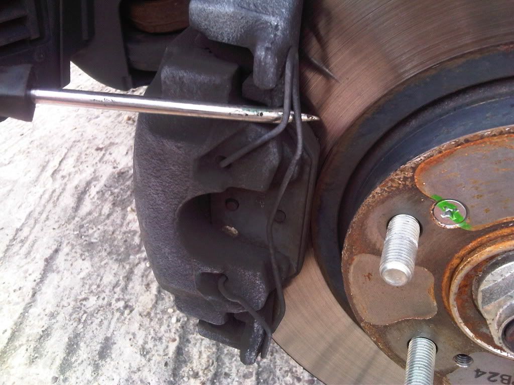

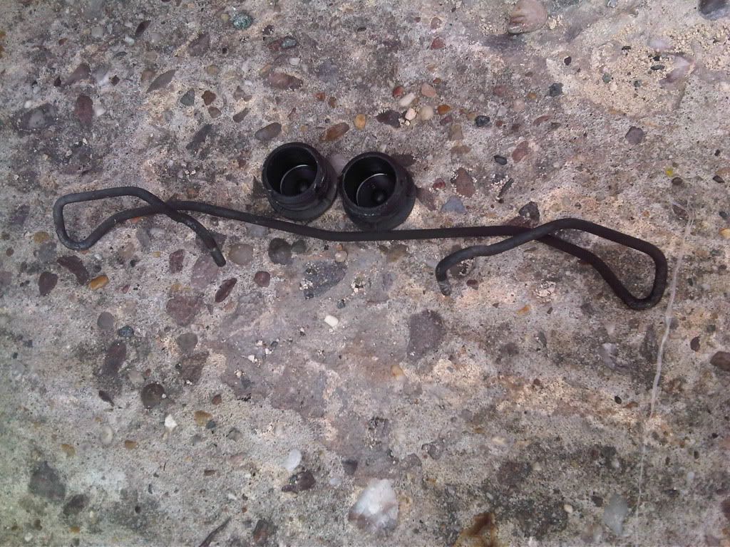

Next step is to remove the retaining spring on the front side of the caliper. I used a small pointed prying tool but a flat blade screw drive should work well too!

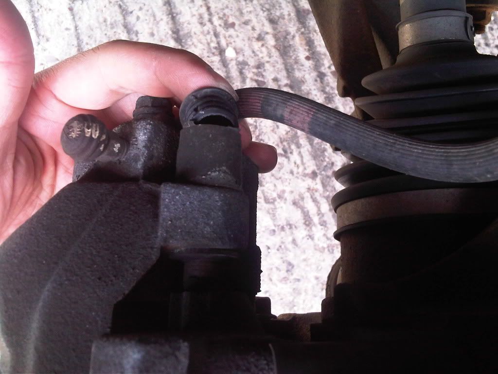

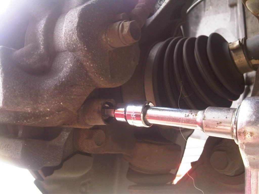

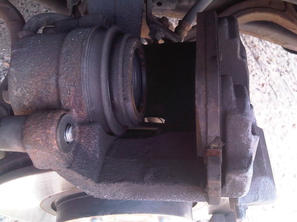

Once the spring is off you will need to remove the 2x plastic caps from the retaining bolts in the back of the caliper. This where you will need the 7mm hex or Allen key to un-do the bolts holding the caliper to the hub ***embly.

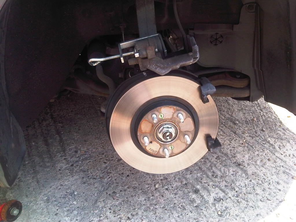

When the caliper is un-bolted, its best to lie underneath the wheel ***embly as i found i had to wiggle the caliper ***embly to get it from around the disc. Once clear of the disc again i found it easier to sit the ***embly on top of the brake disc giving clear access to replace the pads but also not to place any weight on the brake line.

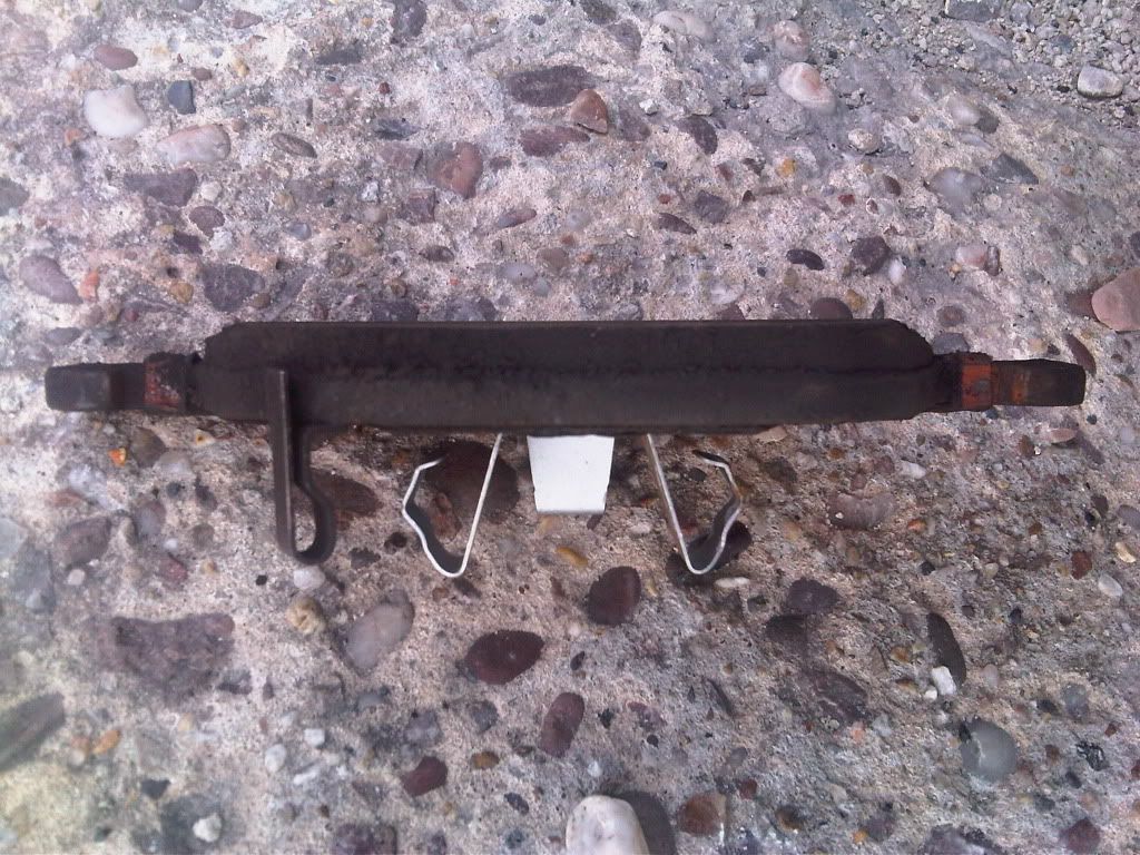

Here's where i hope you have a piston pusher, I managed to borrow one off the guy next door, but did managed to pick one up today from a £1 shop! The worn pads will remove fairly easy. The pad on the piston is held in by the spring clip and the other pad is just placed in the grooves.

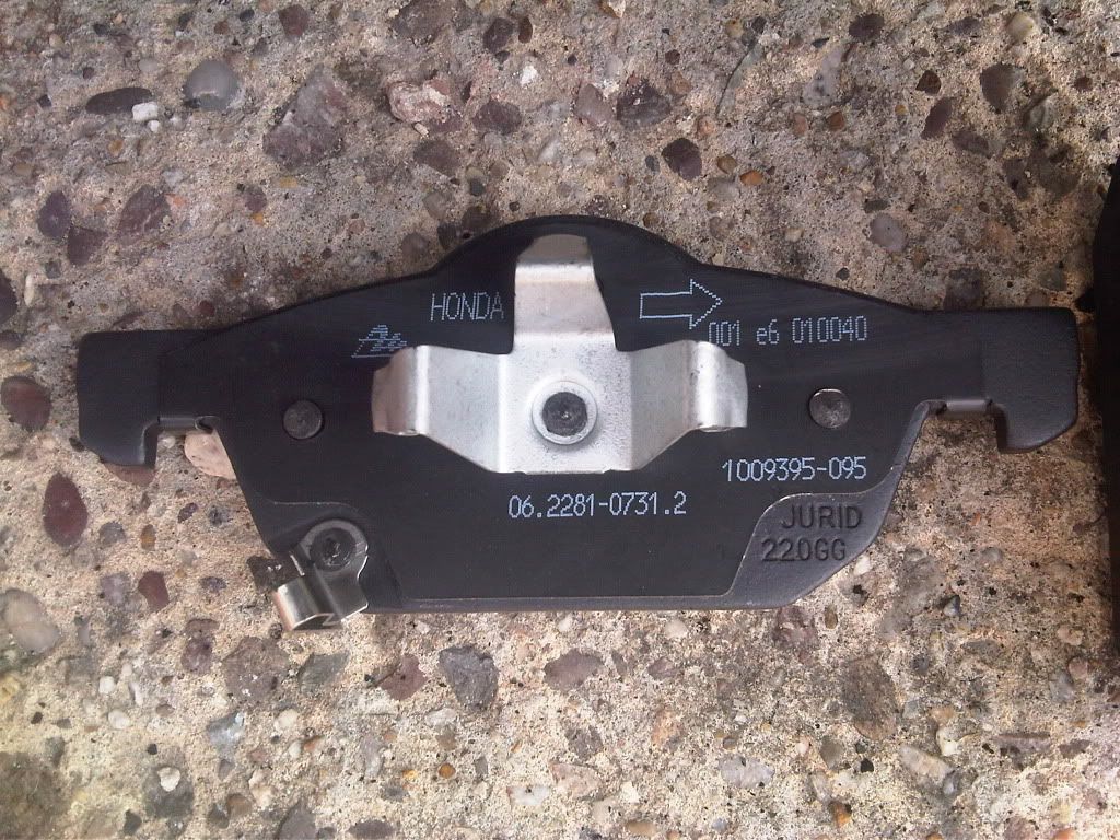

When the old pads were out, i took a couple of minutes to clean out brake dust and copper grease up the grooves where the pads sit and slide about. Before jumping into the new pads and fitting them, note the rotation arrow printed on the pad with the spring clip. I just compared it to the pad i had removed to ensure i had the right one and popped them in!

The only thing I'd add is the torque for the caliper bolts is 28Nm
