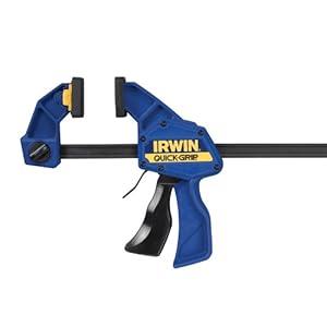

I done mine for the first time last year too, actually quite easy to do. I bought the impact driver specially for doing it.
I didn't use the rewind tool for my fronts, although have it for the backs. I used a one handed 6" clamp that I had already, which was quite efficient to use....like this one here
