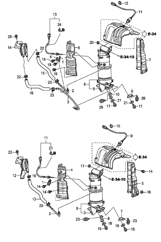

Everywhere I look I see DPF's listed from 2009-2014.
I've noticed it seems pre facelift 2008-2011 the DPF has an extra pipe at the bottom and also the differential pressure sensor has two.
Facelift seems to be missing this extra one. Am I missing something or are all the DPF's listed wrong compatibility wise?
2008-2012
2012+
Yes the dpf on a pre and post facelift are totally different and not interchangeable. In fact the differential pressure sensor and even the ecu are different.
