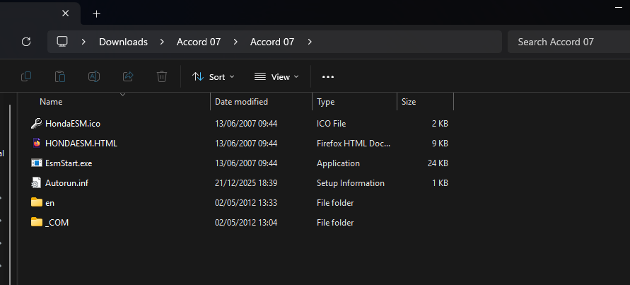

Once extracted, open the folder, open the "Accord 07" folder, and you should see different files named "EsmStart.exe", "HONDAESM.HTML", etc. It should look like the below image. Do not proceed to step 2 until you have found these files.

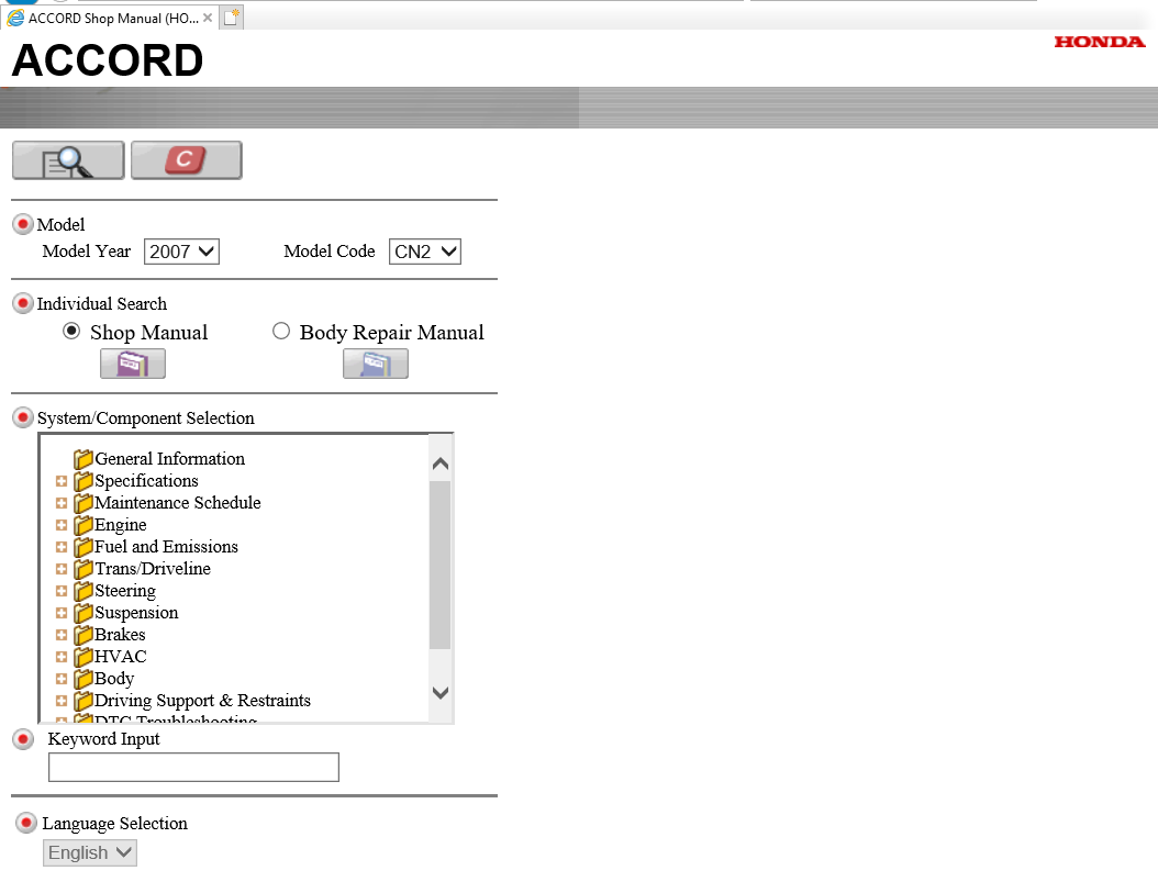

You should then be met with this menu:
Input your cars year and model code. Click on either "Shop Manual" or "Body Repair Manual" depending on what you need advice for. In the section labelled "System/Component selection" you will see a list of systems and components. When you find your desired folder (You can get more precise by clicking the + button next to the file icons", click on the file image so it changes to an open file. Then click the magnifying glass on the top left of the page, and it will open a list of tutorials and resources relating to that part. Click your desired tutorial, and it will open in a new page. You can click on images to zoom in on them for easier reading.
