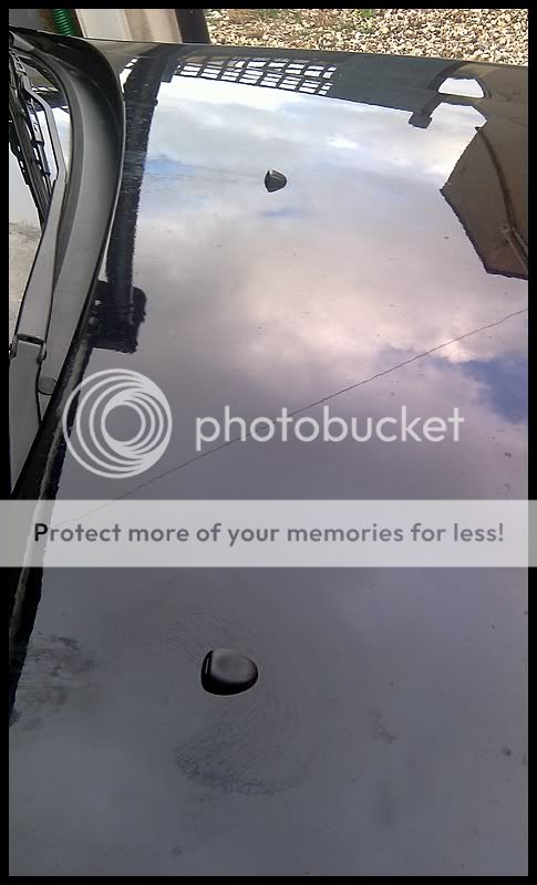

Xsara jet next to an ATR jet.
Driver's side fitted -
Both sides fitted (after a quick trip to Halfords to buy a t-bar pipe splitter as i managed to break the one of the car using BF&I pulling the tubes off the old washer jets!)

I had these on my 5th Gen and swapped them to the ATR. They actually fitted better on the 5th.
They are perhaps a little loose, but it will be easy to make a clip underneath to tighten them up. I like them loose as i can remove them easy when cleaning the bonnet.
