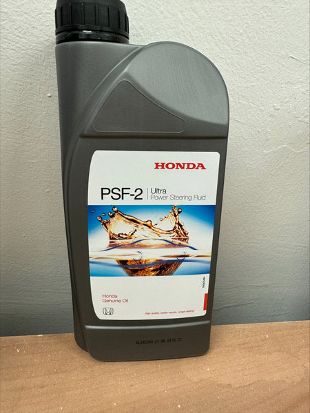

Would be a perfect opportunity to suck and refill with new power steering fluid
I get my honda fluids from here
