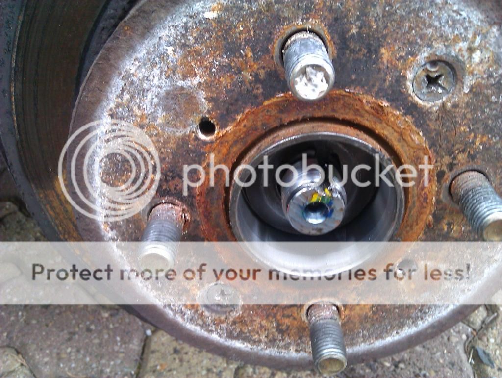

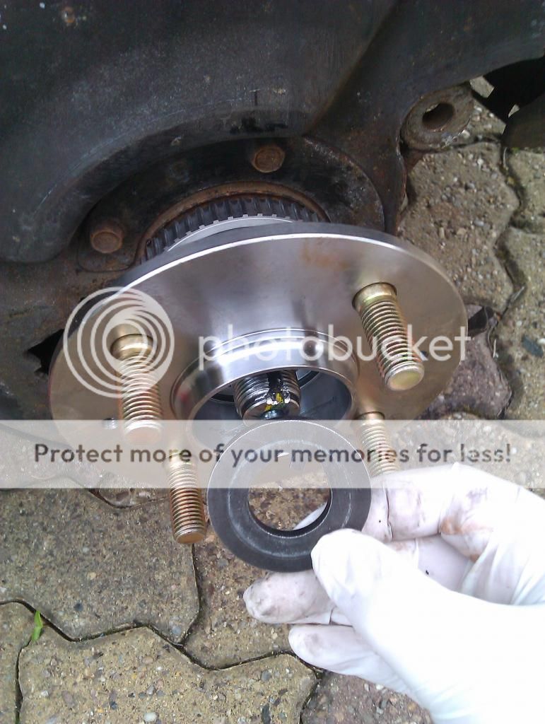

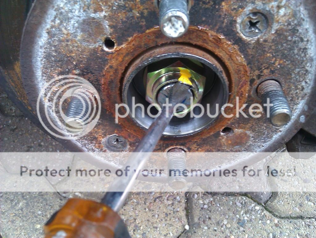

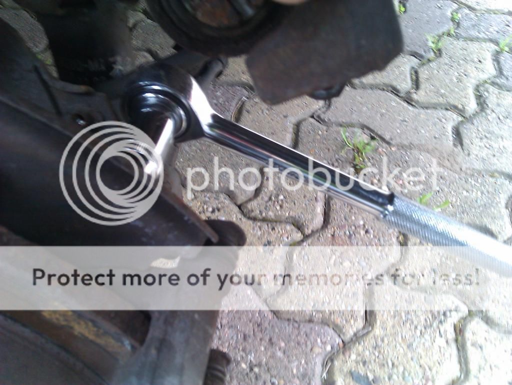

Great write up mate.

The last few shots where test fit shots that's all :lol: I even replaced the retaining screws on the disk :p
Even seated it snug with grease and removed nut again and packed more grease in before returning the cap, its done 15k since and no prob's :)
