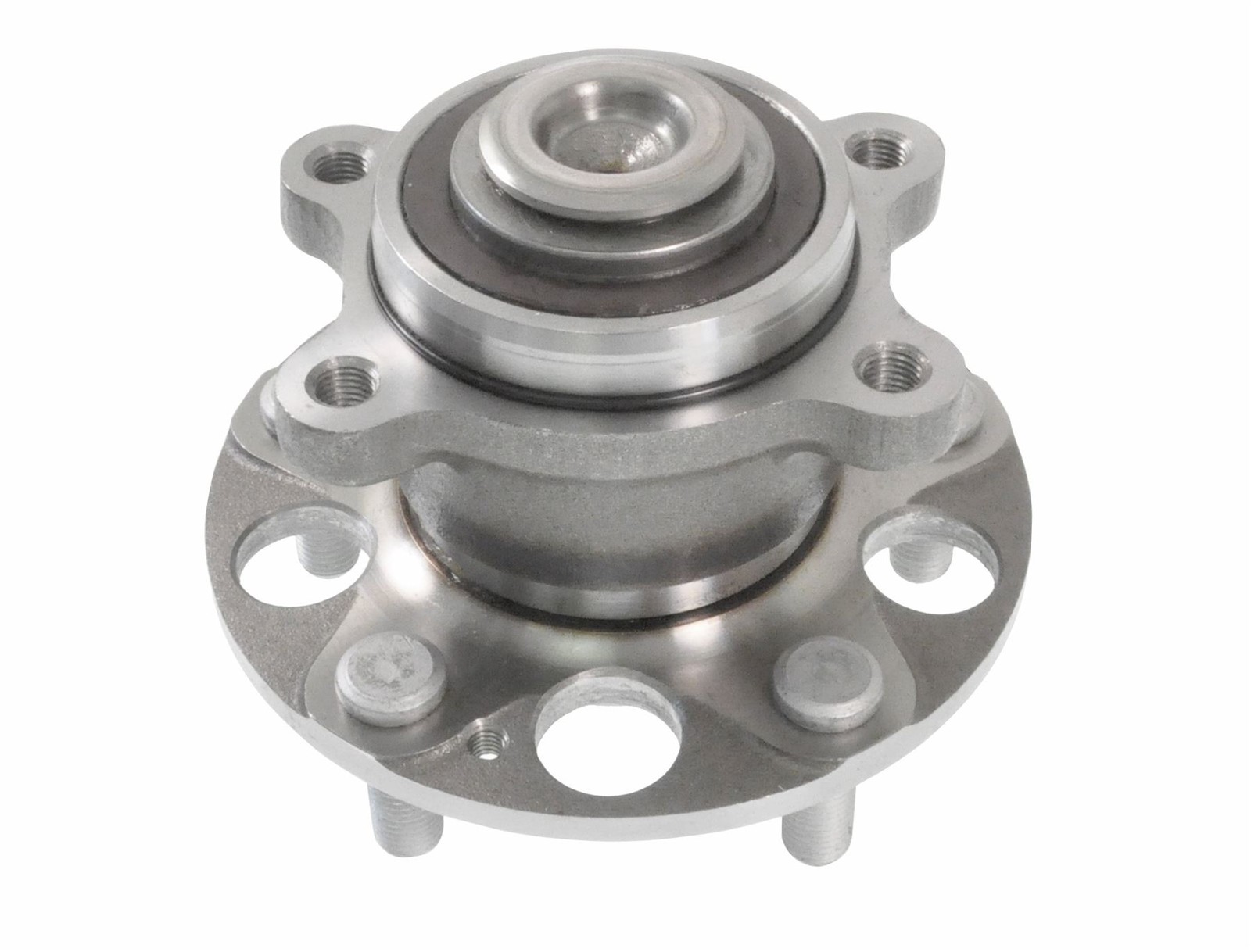

saloon bearings are cheap to buy and easy to do
estate bearings are OEM only AFAIK, and not as easy to do
yes it is fairly common place, IMO not many people know that the rear bearings on their car are wearing out LOL .....because a change to better tyres usually gets rid of noise
as i say, it takes a very long time for the bearings to reach MOT fail, the only way the bearings can fail the MOT is when the bearing feels loose, the clicking sound is not a fail, and as it's difficult for the tester to hear it won't end up as an advisory
edit: some ebay listings (so you can see what they look like) ....saloon ones just bolt on.
http://www.ebay.co.uk/itm/291200789187
http://www.ebay.co.uk/itm/351225396599
http://www.ebay.co.uk/itm/190908664904
and I've seen them cheaper
and the listing usually say saloon AND tourer ....definitely NOT tourer, never seen actual tourer bearings on ebay
Freddo you are an absolute legend
So the saloon units are bolt on ey no need for bearing release tools etc? If that's the case as soon as I isolate the dodgy one(s) I'll get them swapped out

Thanks again freddo appreciate the time you've taken with the pics/links etc .
