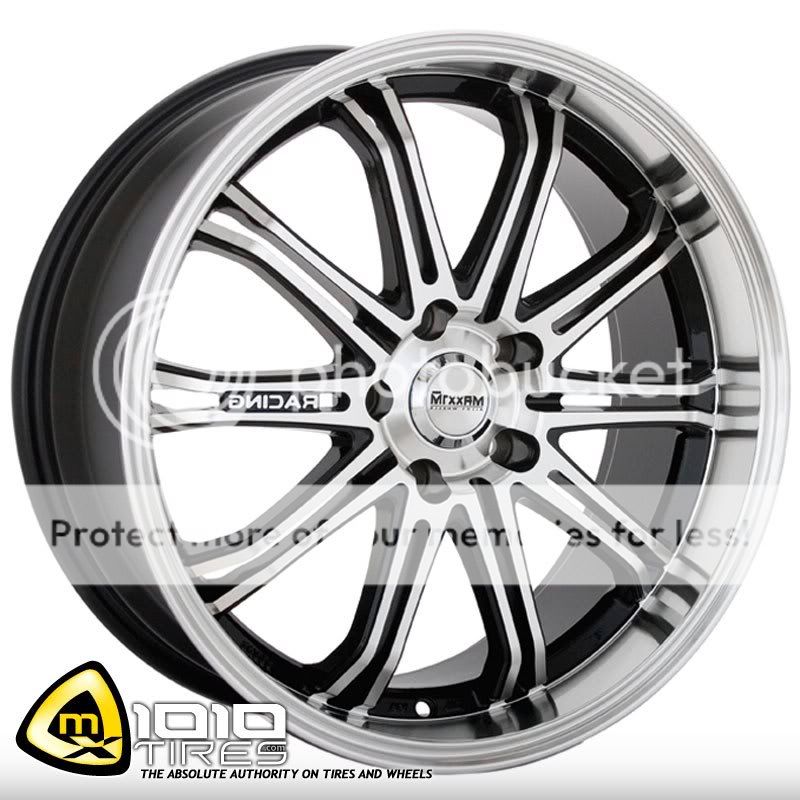

right after searching alot for alloys for 7gen accord iv decided to get these wheels:
they are Work Schwert SC1 alloys, i want them in 18", the only thing is that they are less common to come by then chicken teeth,i tried everywhere in the uk...even thought of importing them but they worked out to be 3000 gbp.... :blink: so anyway after hours of searching, reading and following links(and not to mention lack of sleep...lol)i managed to find these:
they are the maxxim(sub company of konig)Ferris wheels, they are the closest thing iv found to the works alloys(i think)...they are 660.00gbp and are based in Manchester by a company called wheelbase...
so guys i would like to hear your opinions...do they look similar,will they suit, etc, every comment is most welcome guys...also im thinking about getting them in 18'' here is the wheel spec:
* Size : 18 Inch
* Bolt Pattern : 5x100 - 5x114
* Offset : 45
* Finish : Black with Machined Face
or their link: http://www.wheelbasealloys.com/__833
can you guys help me know if they would fit my accord as i have no idea about wheel specs regarding the accord(a bit stupid i knowww...lol)
so can you tell me if the fit, will they clear the brakes and anything else you can tell me.......lol...
just like to say your help guys is always greatly appriciated..thanks again...mo...
what width are they? generally stay clear of 9" width, as standard offset is 50 so 45 is ok but again depends on width.
I've got 18*8 on 225/40 with an offset of 45 and lowered about 4cm and it doesn't catch.....however if you go 235 tyres then i don't know
brakes won't be a concern at all since you're going bigger
sorry alnug have no idea about the width, :blink: did look on their website but no information regarding the width.... :lol: hmmmmmm, i guess the offset is the same as your alnug, and im also going for a 3.5mm all round drop(but remember fahad mentioning to me that the front drops more cos it heavier on diesel)
right just spoke to a very nice guy called dave who said " they are 8 by 18 " if that helps alnug(also they goona take about 4-6 weeks to arrive from the states...)
Mo you'll just about be ok with an 8x18 and ET45 rim as long as you are running the correct 225/40/18 tyres, and don't lower the car by a ridiculous amount. I think you'll be fine mate, go for it.
cool...so 225/40/18 for the correct tires, il remember that bro.....thanks for that fahad, im only trying to achieve a drop so the arches have 1 finger gap between them and the tire, so with 18 i think i should achieve that with 3.5mm drop...right??? also cant go too low s the humps(more like mountains) will take the whole underside of the car off....!!!! :D IT STARTED THAT ON THE DC2, kept hitting exhaust....but with the accord nothing too serious bro...
