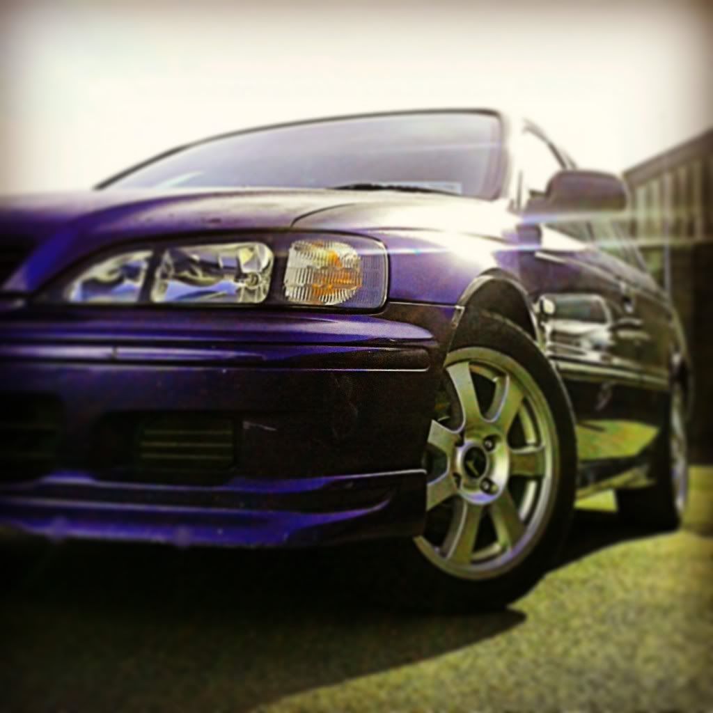

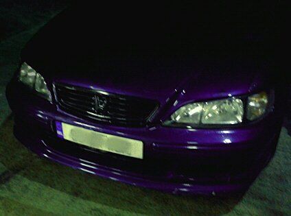

Thanks! I will get some better pictures next time its out to play and make a thread. Heres some oldish ones from my phone, let me know how they appear on the computer!
Back in the 4x114 days!
