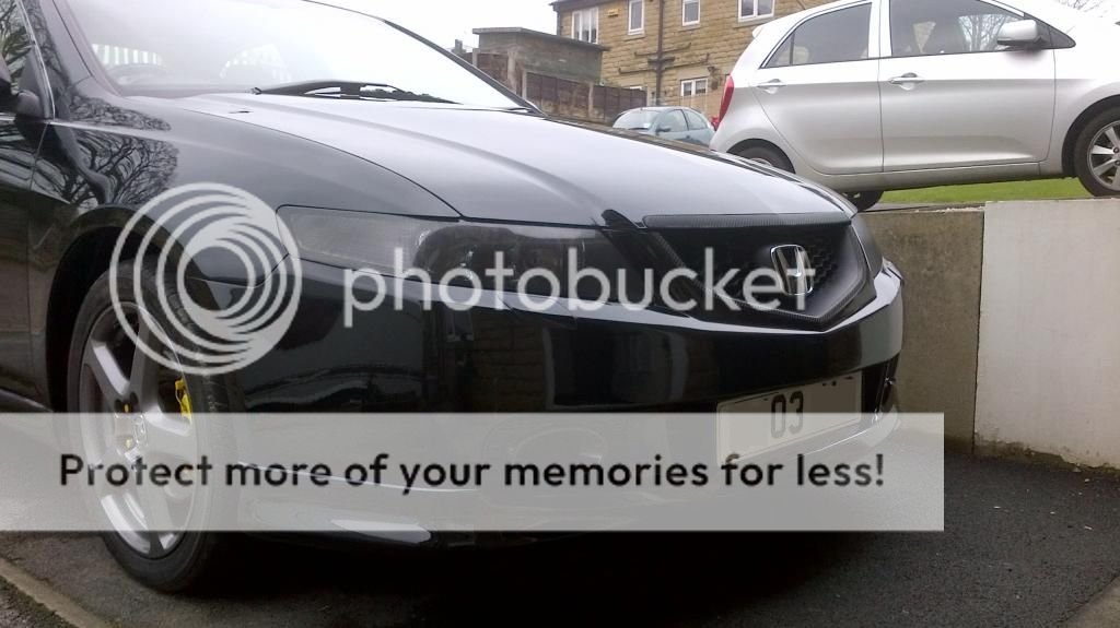

Not sure about the smoked lens's. They look good and I've considered the mod myself, but how does it affect the headlamps and fog output?
I've just put 5k hid's in as the 6k weren't bright enough. if you get a chance can you post a pic of the lights on at night.
I'm still considering doing a light tint of all lights front and back.
well its fly eye on the headlights not a solid film, doesnt affect it very much at all, has small holes in the film to allow more light out, fully legal

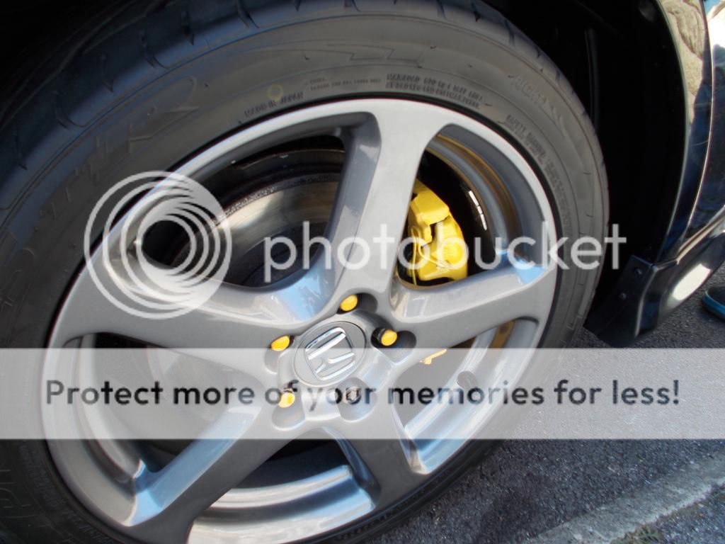

Interesting colour choice. I really like it.
another pic of the caliper

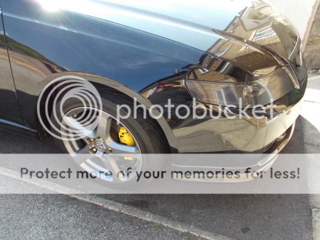

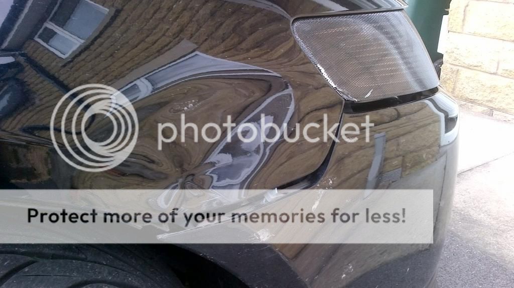

I have recently been bumped and I need a new front bumper just looking at other threads about front bumpers will let everyone know what happens and what I do with it...gutted tho :(
So here is the damage...doesn't look much but that's because I've tided it up so I could drive it whilst I waited for repair, it goes in tomorrow. Its done in the wing, bumper has nearly all its mountings ripped off, the grill has been snapped, the headlights are damaged, the alloy needs refurbing, the steering has been knocked out of alignment so I have quiet a to do list.
Whilst its at the body shop its having the rear bumper touched up as well as the bumper modding before going back on, its having the number plate holes filled in.
the brand new bumper, pretty cheap and the repaired grill, will show all when its done, bit excited to see the results.
I have a brand new o/s headlight but still looking for the n/s, everything else should be ready.

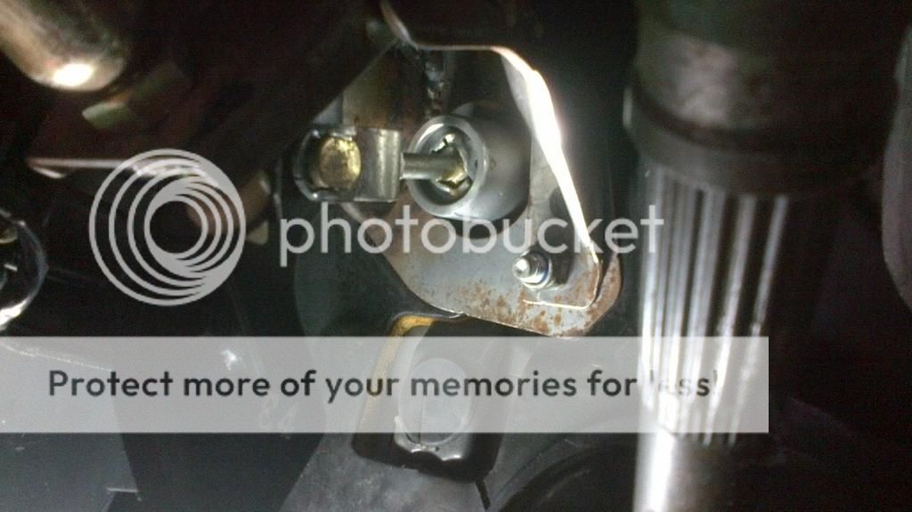

Whilst all this has been going on I have been fighting with a gear issue, really annoying, it doesn't engage 2nd sometimes, it crunches into 1st and reverse sometimes, sometimes it works absolutely fine, I have been attempting to tick off the cheaper jobs first before it goes off for a clutch or gearbox refurb.
the items I have done: I've lubricated the linkages, taken up the slack in the gear selector cables, gearbox oil change, and re-secured the clutch pedal and master cylinder. jobs still to do: clutch fluid change.
The clutch pedal needed doing because the previous owner had problems with the gears before and noticed the clutch pedal bracket had snapped and caused damaged to the master cylinder, so he changed the master cylinder and repaired the pedal but because of a basic mechanical knowledge he had left the most awkward nut loose (not on purpose, it had come loose with use)
the picture shows one of the nuts, the other is hidden behind the metal bracket to the top left, you can see some of the weld from the previous repair above the master cylinder.
this picture shows that you cant see the nut at any position that you can get your head in, it was all done by feel and I had to buy a stubby 12mm spanner. Not fun!

an update on the gear prob, the clutch fluid change and securing the pedal has made a huge difference to the driving experience, it runs really well now

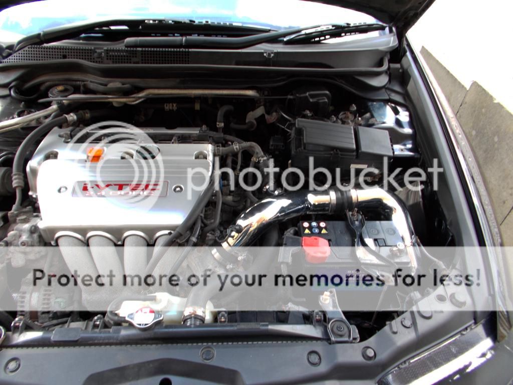

finally turned up and finally fitted
makes a big difference and the induction roar is awsome
HI Joe,
Love the induction kit, where did you get it from as I'm after 1 for my car?
Also noticed that your cone is well down as I can't see it in the picture, have you removed the factory cold air feed to get your pipes to go down that far?
Most other peoples cones are right behind the battery with a heat shield
i got it off amazon of all places, everywhere was sold out
the cone goes down behind the fog light, i've removed my fogs as 1 was broken and it wouldnt fit them with this splitter i've got on, think it lots darker without the fogs anyway so dont miss them.
people have them behind the battery for winter to stop sucking water up into the engine, the good thing about this kit (i think like many) is you can have it long in summer to avoid heat soak and short in winter

Does it have a specific name? Yeh I want 1 that can be converted to short for winter and long for summer ;-)
