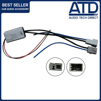

Apologies for the late reply. Thanks for the advice. I will investigate the FM expander unit.

Bit of a late reply but where did you get to with this?
Reason being I have been looking at the options for my UK delivered car - not the same as yours but similar issues
Wanting to avoid dubious Chinese Android head units the best I could come up with is basically converting the car back to "base model" spec without the nav screen and then fitting a double DIN adaptor but its horribly expensive. This was my list I put together before bowing out:
