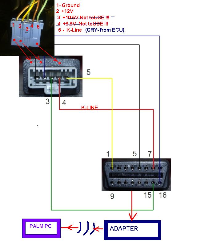

Hey,
Finally got the diagram :)
This is the connection diagram of the adaptor that I have. The pin numbers that I have ***igned to each pin was chosen by me, not following any standards. Also, this is the diagram of the adaptor, and those are actual pictures of the adaptor connectors, so you have to make sure to adapt the diagram in order to connect the 5 pin connector directly to your obd connector.
If you have any question/doubt regarding the diagram let me know, I can test it again for you ;)

Hi Skhel
I check 5pin plug in my car by multimetr and modify "our schem connection"
See:
I check manual "Honda ESM Accord" and find K_Line output from ECM connector A(32P) -> 21, also GRY. See:
So, I think now all will be must to work. But only HOW You to connect 5pins plug from car and 5pins to cabel ??? May be by wires ???
May be to change 4 <-> 5 on plug ??? Or output #3 pin from plug and change 4<->5 pin ???
Becouse I dont know about 10.5v 9.8v signal on 5 pins plug.
Anyway, write Me about your experiments and results !!!
