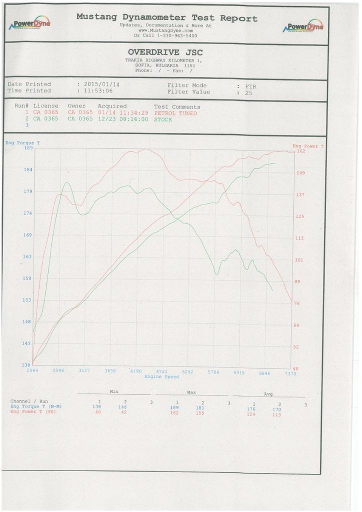

One more reflashed CM2 - mine :)
I met with Dinu in Bucharest for a reflash of my CM2. There's a noticeable difference, especially after 3000rpm, the throttle pedal also feels much more responsive, I mean you don't need to push it so hard to maintain the current speed on an uphill or downshift to a lower gear, for example. The rpms increase far more easily now. Basically, there's not much increase in the max whp of the engine, but the torque is more distributed throughout the whole RPM range. And the earlier engagement of the VTEC, of course is very very nice, there isn't that much of a "vtec kick in yo" effect like in the earlier B engines, the transition is very smooth and the car pulls strong without hesitation up to the limiter.
Here is a before/after dyno graph:
The graphs shows output on the wheels without any corrections. The dyno is also a very sensitive one. I have a graph with petrol/LPG comparison as well, if someone's interested :)
nice to see an at-the-wheels before-after comparison at last !!
but why did they use invisible ink :lol:

Yep, this is the dyno sheet for my car :) Been driving the reflashed ECU for 4 months now, really pleased, no problems with the engine or the mpg, 21-22mpg urban, but this is on LPG so I suppose it would be somewhere around 23-24 on petrol. Massive difference when towing :)
