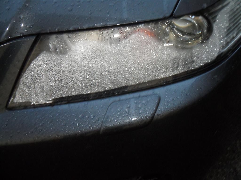

Im just trying to get an idea of how many members have misty headlights.
My car is an 03 and had the clips installed in 2007 and my headlights still mist badly, Honda have refused to replace my lights because apparently there has never been an issue after the TSB (recall) to get the clips installed in 2007.
So they refuse to accept any blame for my lights and if i want them replaced they expect me to pay £600 + fitting for new headlights.
I am aware that other members of this forum have had problems before and after the clips were installed on there headlights so im trying to get an idea to confront Honda with.
I have attached a couple of photo's so you know what im talking about, These were taken after a car wash and they do mist up a lot worse in the rain and are very bad in the snow we have had recently. Bad enough to reduce light output which is dangerous in my eyes.
I will be sending Honda a letter in the new year asking for my lights to be replaced free of charge as they were obviously defective when they left the factory and the TSB has solved nothing.
My experience with Honda may be beneficial to other members if i am successful in getting my lights replaced free of charge.

Only way with this will be to remove headlights dry them out, hair dryer / near radiator works well but they need to be 100% dry. Then as CJ recommends you need some silica gel packs inside and check all the seals properly. The main beam cap seals have a habit of getting twisted or caught up by previous owners who where impatient especially on the diesel as access on the drivers side is tight.

Fella that isn't bad for headlight condensation. get two medium size silica gel bags for each headlight from ebay....and that will be history I can ***ure you.
Also get the low beam covers off and look at the large O ring look out for distortion and cracks even the smallest imperfection change them. if you do make sure they are slowly and correctly installed.
Majority of the times it these caps which are not sealing correctly.
Thats just after washing the car, They get much worse in the wet and snow.
If you read the TSB you will find that it clearly states that if water is present the lights should be replaced. In your case it seems that water was still inside the clusters when the clips were installed. So you are quite within your rights to demand new lights. All they have done is seal water inside with the clips.

My headlights misted a bit worse than above photo. Dealer had installed clips. Went back and explained they were still misting. Asked me to take a photo of them when bad which they sent to Honda UK and got new headlamps fitted FOC.

If headlights are ok, don't get them clipped - the problem is caused by the seals between the glass and the reflector breaking down and the clips - instead of pressing the 2 pieces together - can break an ok seal. I personally would not be happy with a silica bag - honestly I'd consider it a fire risk. Even if I'm wrong, having a bag of crystals sliding around inside the light doesn't strike me as a very professional fix.

A blob of something like Fernox LSX or other silicone sealant (check for heat tolerances first though) can be used as a very effective none permanent adhesive - when it cures it uses suction to adhere - therefore easy to scrape off afterwards.

Stuart thats terrible looking, that must have a real negative impact on the light. Considering I got mine done FOC and was nowhere near as bad as that I wonder should you give it another go?
my drivers side light unit is similar if not worse .it started with a light misting 2yrs ago. iv'e tried the hairdryer and have drilled a small hole but to no avail.
