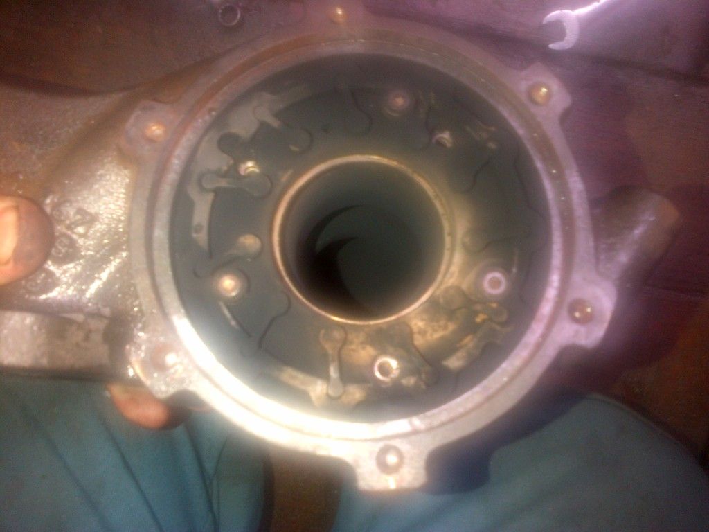

Sorry for the lack of photos I thought I took more than I acctual have.

Then remove 3x14mm nuts holding the turbo to the manifold. Slide the turbo off and turn it sideways to slide it down through between the driveshaft and the subframe.
