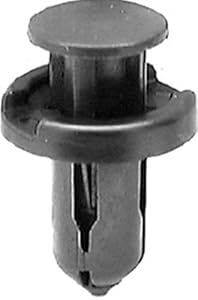

You could use any screws I guess, I think there are some clips over the holes also on the bumper. The original screws have big heads, and are sort of a brown colour, treated so they done rust, might look better to use those, and get those clips also, see below.
The plastic clips however, you can get them from Honda, but they are cheaper on Ebay, get a few of both lengths.
http://www.ebay.co.uk/itm/20x-Honda-Push-Fit-Plastic-Rivet-Fastener-Clip-Bumpers-Side-Skirts-Grills-/280770436651?pt=UK_CarsParts_Vehicles_CarParts_SM&fits=Car+Make%3AHonda&hash=item415f38de2b
