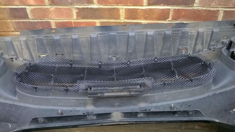

I can't remember what hole size I've got but defo it's more than 5mm x 12mm, anyway I used hot glue to attached mesh to the bumper and here's result
Looks good mate, so the glue holds it ok? Have you removed the standard plastic grille, did it make it easier to fit the mesh?
I had to remove plastic grille because I didn't have enough room for fmic and yes hot glue holds it great without any nasty drilling in the bumper or zip ties ;-)

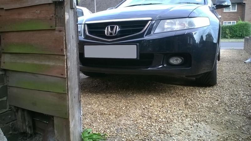

As I was only doing this to protect the condenser rather than styling I opted for some gutter guard - http://www.amazon.co.uk/Blackspur-BB-GM100-Gutter-Mesh/dp/B005EXIMPI/ref=pd_sim_lp_21?ie=UTF8&refRID=1XEJXKB2F5QNT3Z658Z4
It's obviously not as strong as metal but I doubled it up and attached it to the existing grille with cable ties. A few additional holes had to be drilled so I could fix it on properly. Time will tell as to whether it holds up but at £2 it was worth a try and you can't even see it on the car :)
Yours is more visible though Wozza, for that purpose I would've used metal mesh as well :)
I think this gutter guard should be fine for stones, hopefully they won't split it but it'll definitely keep the wet leaves and feathers away.
