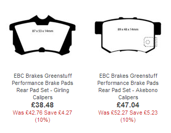

I need to buy new rear pads for my 2.2 i-ctdi saloon, however when I have put my make and model of car into demontweeks (bit cheeky they give you the ebc part no. then i look else where with part number) but it comes up with 2 different rear brake pads depending on which caliper I have (see pic below)
Can anyone advise on which one I need?
The set on the left is the correct ones for the saloon.These has the 2 nipples in to line up with your calliper and you will need a wind back tool to wind the calliper back in to fit the new pads.
Just make sure the slots align up or you're pads will not sit proper and wear out in a few miles of driving.
From memory the calliper slots need to be vertical

Brett... the link you provided agrees with me and John!
The saloon rear pads are the ones on the left.
Yep sorry Jon my bad I'm getting my left and right the wrong way around lol it's the ones on the left for the saloon.
