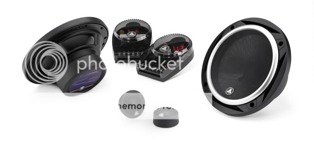

Front component speakers JL Audio C2-650
