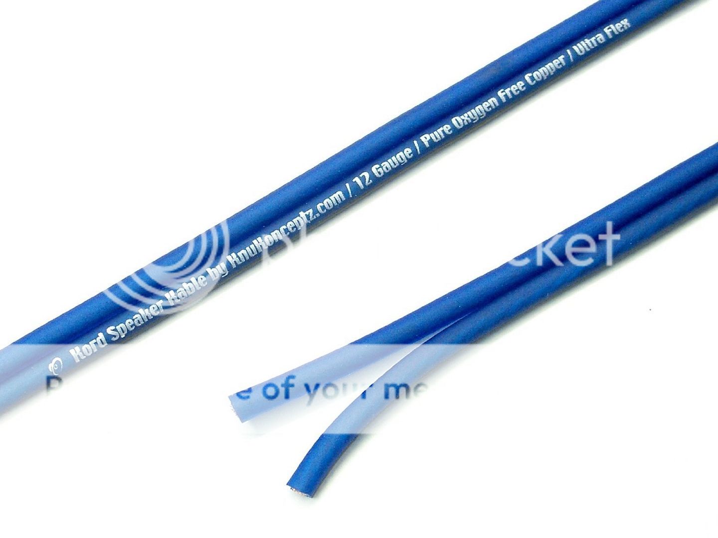

New speaker cable ordered for the front soundstage. I need the cable for the other speakers to be tonally the same, and I will need to run new cables from the amplifier, into the doors, then from the crossovers to the drivers themselves. I need to buy over as I am not going to add bits or splice with the existing stuff, the cable is best bought in 1 complete length, then you cut off at exactly the point you need without wasting any, or coming up slightly short. As the cable I previously installed has gone up markedly in price, I have decided to shop around for the best stuff I can get for the same sort of price that around 12-14m of the existing stuff would cost me.
Without putting home HQ Hi-FI cable in, I have kept with a car Hi-FI brand I already know & trust, & have used before in my install. It's pretty chunky stuff, but it will ensure very little power is wasted along it's run of 4+m, and will ensure once these upgrades are done, I will be totally happy & no longer be burdening my flexible friend with any further debt.
KnuKonceptz Kord Speaker Wire Ultra Flex Blue OFC 12 Gauge
Core Material: 36 Gauge Bare Oxygen Free Copper - 294 Strands x 2
Dielectric: Ultra Flex PVC
A: 9mm
B: 4.5mm

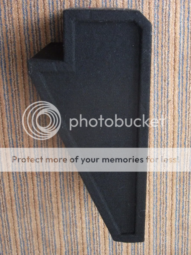

OK I officially have an ICE addiction problem. I'm buying another Subwoofer to mount in the front passenger footwell firing straight at the front seat. As bass is mono & not really directional it will integrate fine into the system when set up correctly. It's cheap as chips on eBay plus I just sold my old 32gb iPhone 5 so it's already paid for & then some.
Everyone needs more bass right? Oh come on its only a small one but will kick hard where my large 12W7 Subwoofer starts to roll off at 80-120Hz. It does mean that my 3 driver door builds will now drop to 2 as I have no more room so cannot fit any more amplifiers, but as most people think 1x set of C3's in the front doors is enough already, it should still be sufficient upgrading to running 2x sets in the front doors & this additional 250w RMS Subwoofer
http://www.jlaudio.co.uk/8w3v3-4-car-audio-w3v3-subwoofer-drivers-92148
It will require a custom box similar in construction to this so as not to take up too much footwell space.
