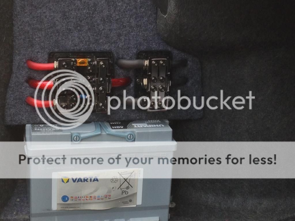

17 Bolting Battery Down
17A MDF Battery Clamp Machined Sanded & Carpeted. A T-Nut was installed on the other side of the battery, where a standard Battery clamp is fitted & bolted down into the MDF Battery Floor
18 Fuse Box & Ground Block Cabling
19 Covers On

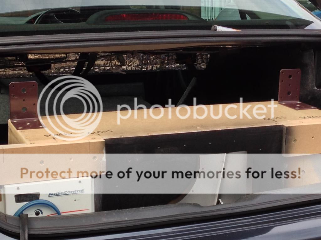

20 Box Bolted into position behind the rear seats
21 Sealing the Perspex Window
22 Screwing in too early.... The Box is secured by 2 large brakets into a crossmember, the Amp Rack is bolted into the Sub Box via the captive T-Nuts, & we had forgotten to bolt it down before putting the window on. With the Subwoofer already in, there is no access except thru the Window Cavity, so off came the window and the Amp Rack was bolted in, then the window went back in..

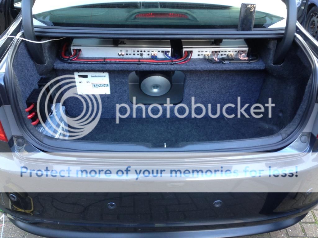

27 Boot Install Arty Shot
28 Friggin Front Speakers :(
