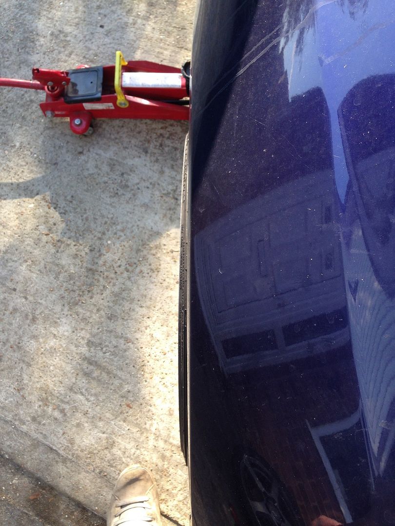

This is an 8.5x19 ET42 front with a stretched 225/35 tyre
