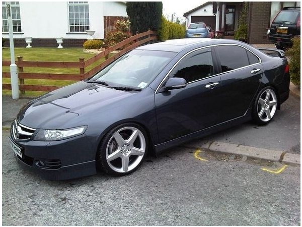

However, I eventually manage to come across a few images of the 7th Gen with staggered AMG merc rims at 5x112 which I really really like.
My question to all the wheel guru's is what would be the best approach to get these to fit ? replace hubs ? Wobble nuts ? Any suggestions and links to what I may need would be much appreciated.

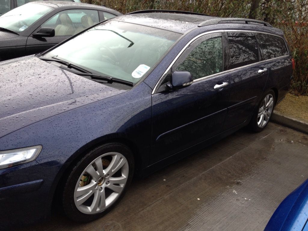

here's my tourer with C class 17" winter wheels
