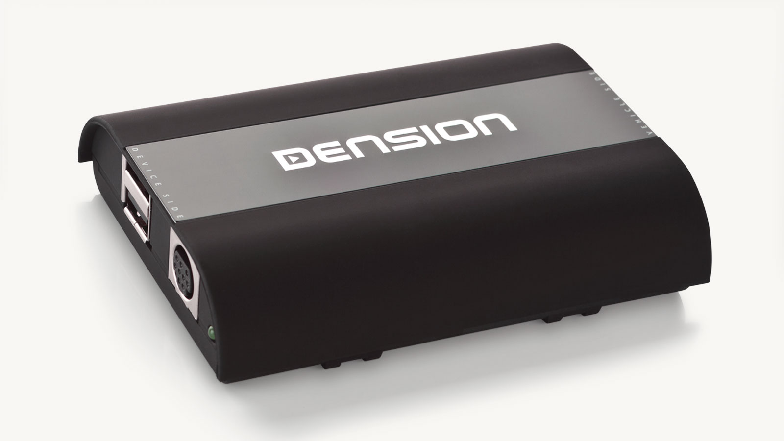

I found Dension DAB+U , it plugs in to original usb port and it simulates it in tu mp3 , in the build in playlist there are functions for search the stations and than it makes more files in the playlist appearing like they are mp3s for different stations so you can use your steering commands or on the radio to change stations. Also theres some kind of built in buffer that works with oem FM buffer , dont know what that is, and they offer a pass through for USB so you can use both the DAB+ system and usb plug for your regular use, no need to unplug the dab .
Ohh and there is antena that you need to put somewhere.
The site is in slovenian language ,
