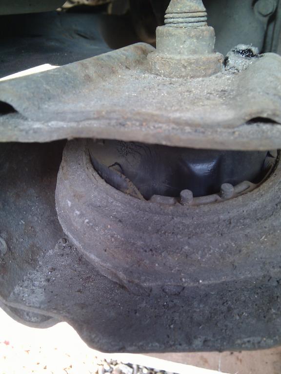

I've been hearing knocking under the accord for ages so thought I would take a closer look. I'm pretty sure the wishbones aren't supposed to be resting on the metal sub frame. Any idea how much it's gonna cost me to have new genuine stuff fitted? Would have a crack at it myself but I haven't got anywhere dry to work on it and the weather is pretty skanky.

These are common to fail. The part itself is reasonable from Honda - I would use genuine parts for this. Old bush needs to be pressed out, then new part pressed in. in. No more than 45 minutes a side I would guess. I need to do this on the CRV soon, just waiting for the weather to clear up.
Yeah compliance bushes - about £20 a side for the part (well it was €25 over here).
I've done them myself, it'll take a little longer than 45 minutes a side though, the whole lower arm has to come out and removing and pressing the bushing a good bit of work.
You'll need to get an alignment after the change too. I never done the video of how to change these as I've one done 1 car (my own). But if I ever do, I'll pop up a how-to video

Bought them for the FRV for £14 a side from Huddersfield Honda last year and mate pressed them in for a tenner.
Just done all the bushes and links on my brothers K24 but we dropped the whole subframe to make it easier
Not a massive job in reality. Just make sure you mark the bush fitting as the slits are there for a reason and need to face the same way when you push the new bushes in.

Got the new bushes fitted on the weekend. Sadly it didn't stop the very annoying knocking sound underneath so after taking another look i'm now going to change the rear anti roll bar bushes which are slack as hell. Haven't had an alignment done yet but managed to change the bushes without removing the arms. Just pushed the arm out enough with a pry bar to get them done. Will get a four wheel alignment done when i've changed the rear bushes. Just fitted 2 new Michelin as the continentals that I had were down to the nylon on the inner edge (woops).
