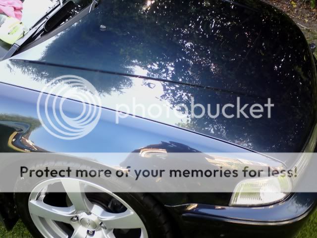

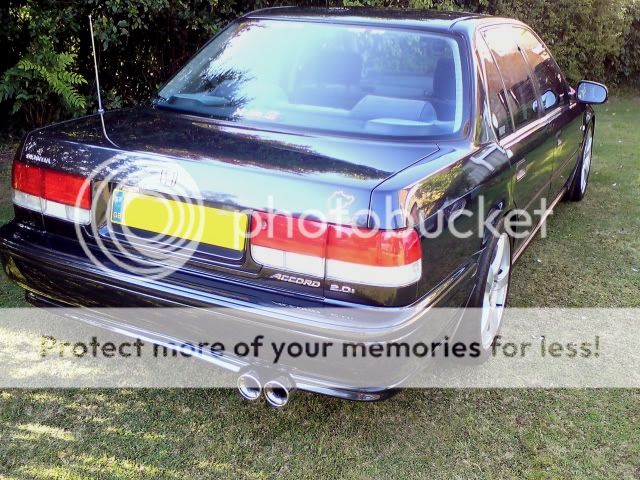

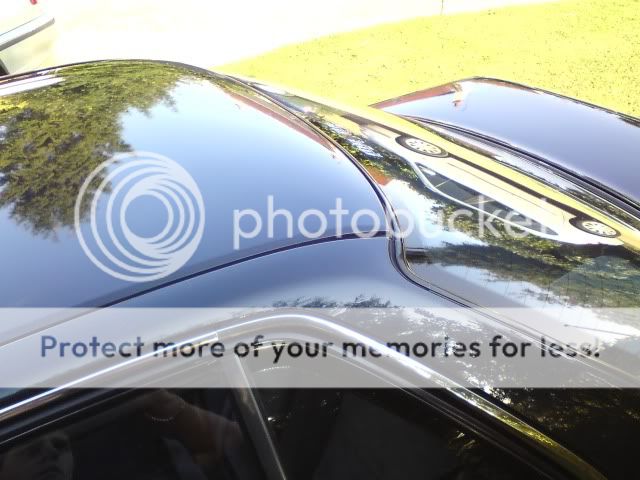

Well i cleaned the car, and used the Poorboys Blackhole with applicator pad and microfibre, the manual method.
Im really happy with the finish, i havent got the best camera to show this product off on my car but youll get the idea!
I use BH on mine, to get the best results you need to do it at least twice. SRP is okay but again it needs to be done quite a few times to get the desired effect (AG recommend at least five - but then they would). You don't use SRP and BH together, anything you put on will be taken off by the one going over the top and you greatly increase the chances of holograms. As mentioned above, if you have a DA use it on a low speed.
I always top BH off with a couple of coats of EX-P then a couple of coats of Colly 915.
