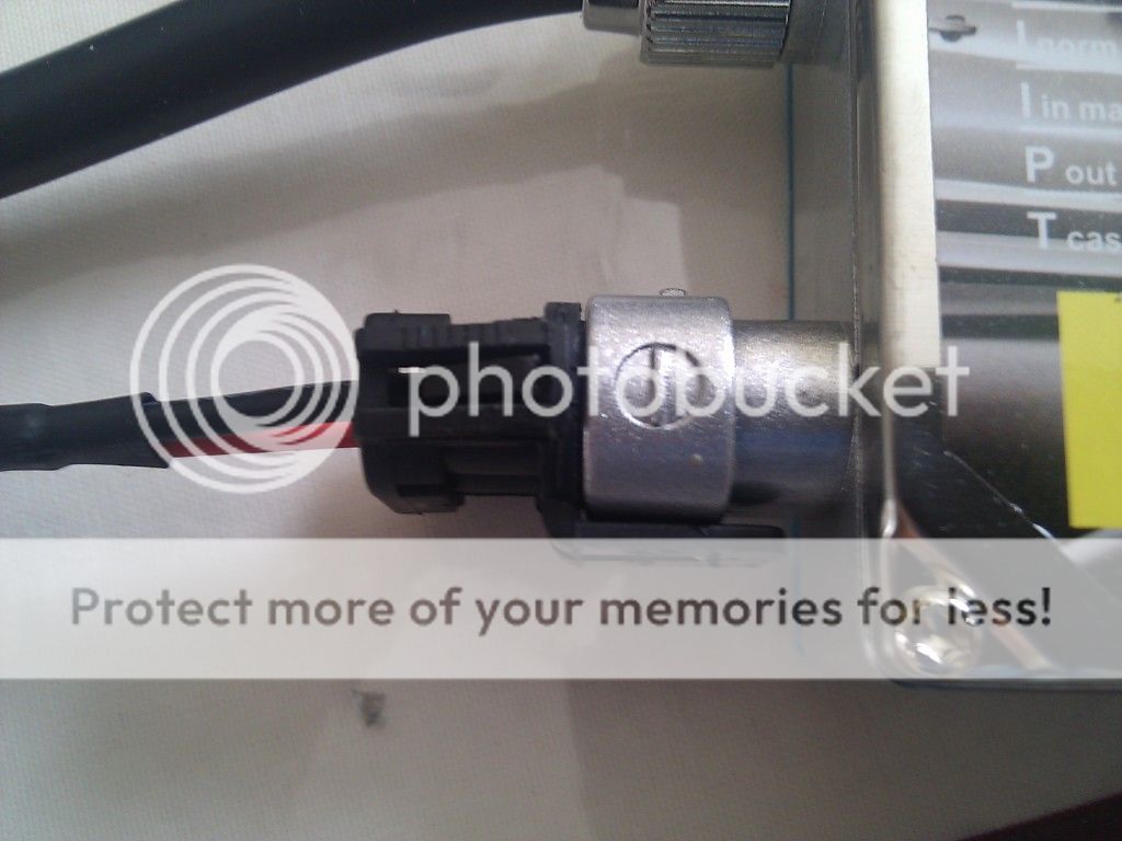

well firstly i fixed up the connectors to the ballast, the ballast its self had positive an negative so you couldn't get it the wrong way round..

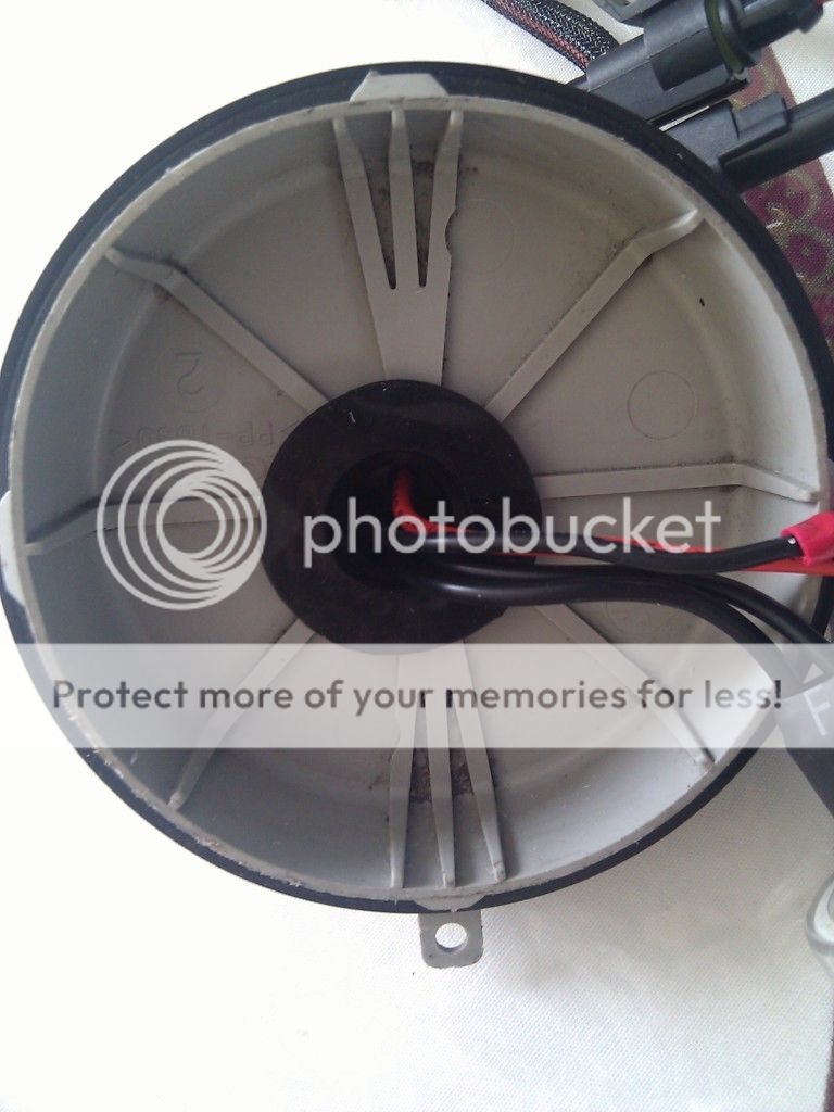

then had to drill a hole in the headlight covers,this was done using a drill..simples...

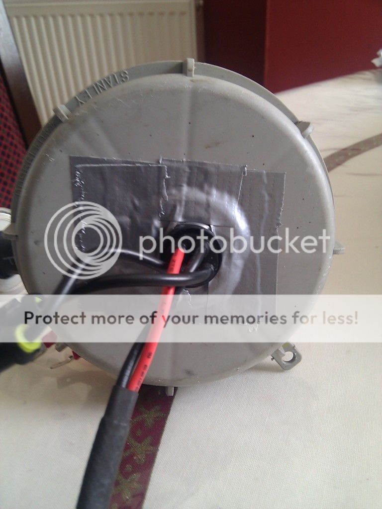

i did put duct tape on the front and the back of the washer plug to make it more air tight..hopefully this should keep the moisture out

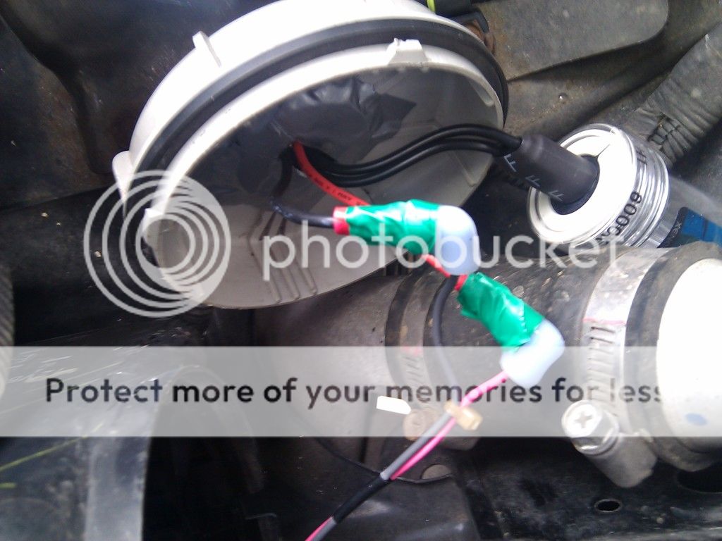

then i disconnected the battery and took it out to give me more room to work around.i took out the existing xenon bulb out and also detached the black wire which went on the metal housing inside the headlight unit its self..

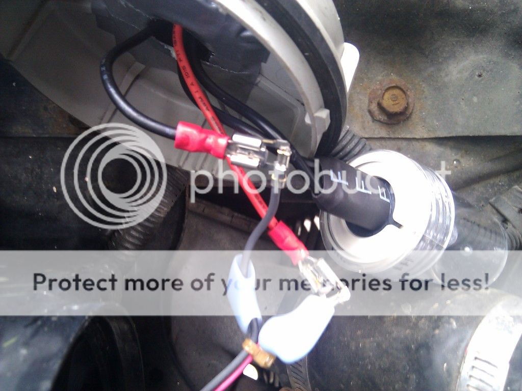

it was then simply attaching the red hid wire to the red one which goes to the back of the bulb,and the black hid one to the black wire which attaches to the bulb housing,i secure the connectors using elec tape,then re taped them after i put the rubber bit on
