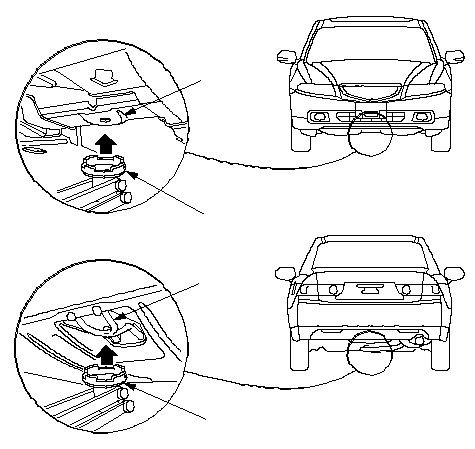

However I have a silly question, where do you position your hydraulic jack on the rear and front?
I would usually place axel stands on the sills (where the scissor jack would go).
Thanks guys
Sent from my ONE A2003 using Tapatalk
Heres a diagram for where to position the jack on the front and rear of a 7th gen accord saloon.
It will allow you to place axle stands on either side once high enough.
Thank you very much.
Looks like I may need to get some wood under my hydraulic jack to get the height.
