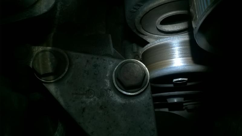

I forgot to say the idler pulley has a different coloured line on it like the belt isn't making proper contact in that area. Could that be a sign the tensioner needs replacing as well. I have noticed it does seem to vibrate a bit as well, especially when the aircon is on.

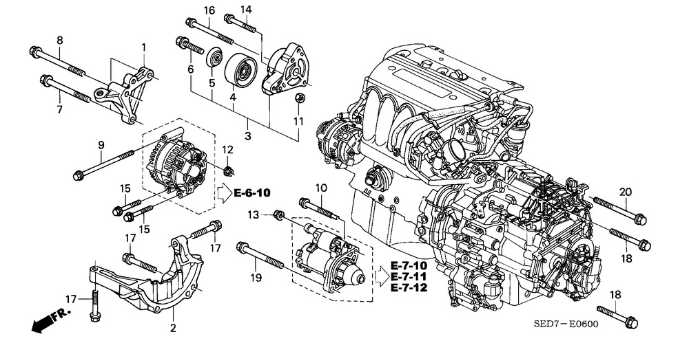

This is the diagram for the idler pulley (no.4) or the whole thing with tensioner (no.3) - http://www.lingshondaparts.com/honda_car_parts_selection.php?block_01=17SED01&block_02=E__0600&block_03=443&block_05=hcr
