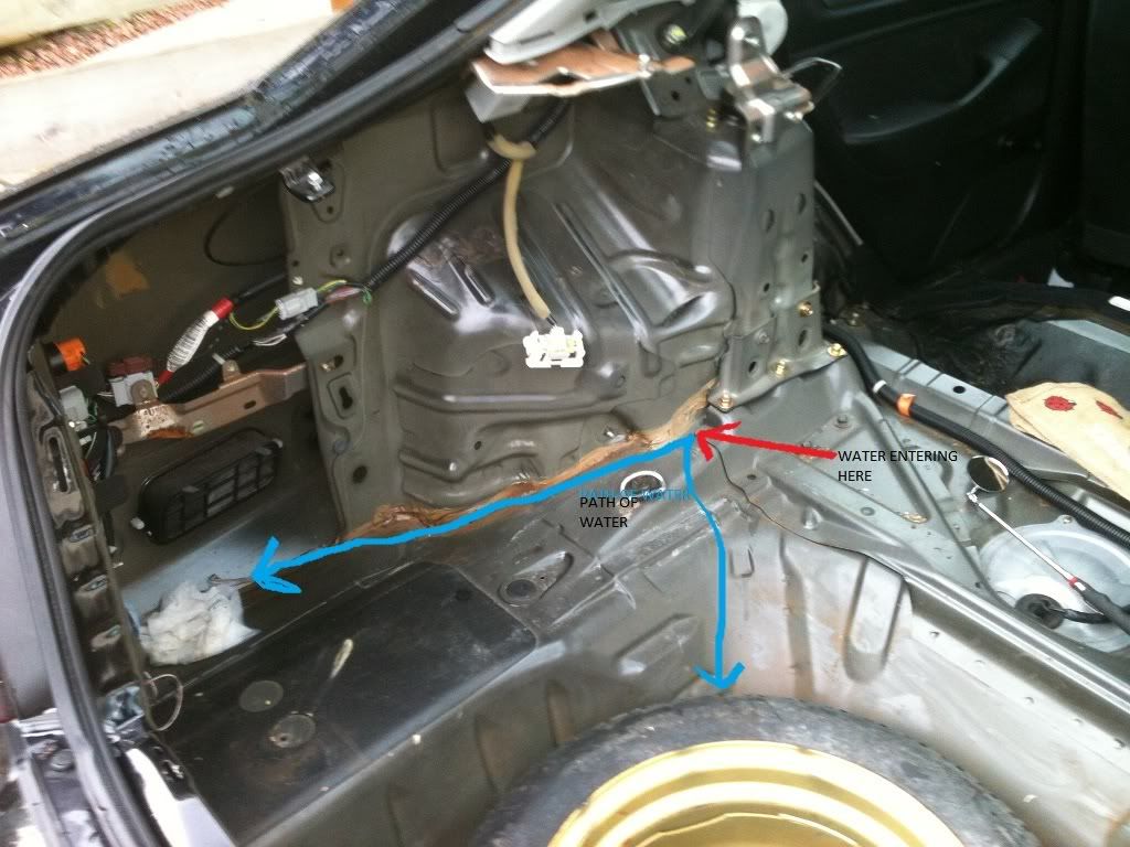

Just typed a 20min reply only to delete it by accident. Short version
Red arrow = water first spotted here
Blue arrows=Path of water
Leak= rear window washer gasket
Solution i hope= Silicon(lots of)
