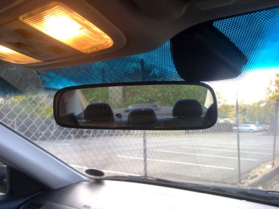

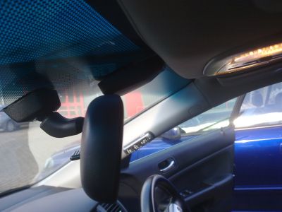

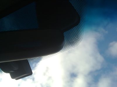

I've just had my windscreen replaced but have an issue in that the rear view mirror and rain sensor are now fighting for the same space. It wasn't like this before the replacement but I need some proof it shouldn't be like it is (and hopefully some guidance on what it should look like). I wonder if someone's got a picture of their rear view mirror or could describe how the mirror should move around the rain sensor (below/beside etc)?
This is what mine looks like:

Is the rear view mirror in the correct position? It seems it was glued a bit too high.
The mirror has been mounted too high mate. The rain sensor position can't change, so it's the mirror.

Delbert, not sure if it makes sense but have you tilted your mirror forward i.e. the anti glare feature, maybe that coupled with the usual setting you use are causing it to catch?
I don't think that should happen as it means that the design was bad from factory... but you never know.
Thanks for the idea Fahad, either way I try the mirror it just doesn't seem right. It's even worse for my girlfriend, as she's a few inches shorter she ends up with the mirror just off horizontal to clear the rain sensor.
It does seem like bad design on Honda's part, it's like the rain sensor is on the wrong side of the mirror for a right hand drive car (although the cut out in the roof lining is on the right hand side so it is where it was originally designed to be).

There is nothing wrong with your mirror mate thats how they are its fitted correctly. Please note that the facelift accord has a different mirror, it is electric auto dimming mirror with sensors etc... I have just has my windscreen and trim fitted from autoglass as it cracked and also damaged the side trim... they fitted it all and also a genuine screen too... so far so good they seem to have done a great job on it.
But from them pictures that is normal mate.
^^^ His cars not a facelift, he's got a standard mirror.
It does look a little tight to me, the mirror seems to be mounted high. But as you say the fixing is factory bonded to the screen.
Have you tried to rotate the mirror arm to 180 degrees so the curve points downwards, not up? That might solve your problem
Thanks Krasimir, that's a very interesting idea, it does look like the angle the mirror fits onto the screen might be adjustable (I'll have a look later). I don't think it's 180 degrees out though, it would be pointing out at a very strange angle if I did that.
