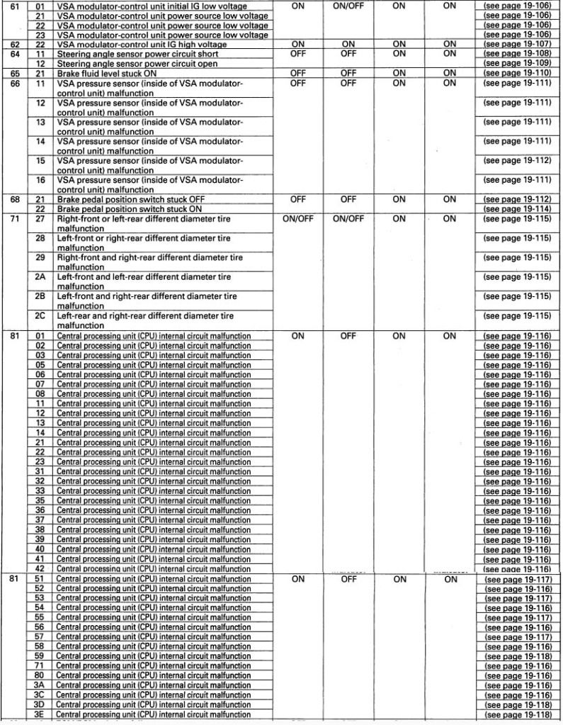

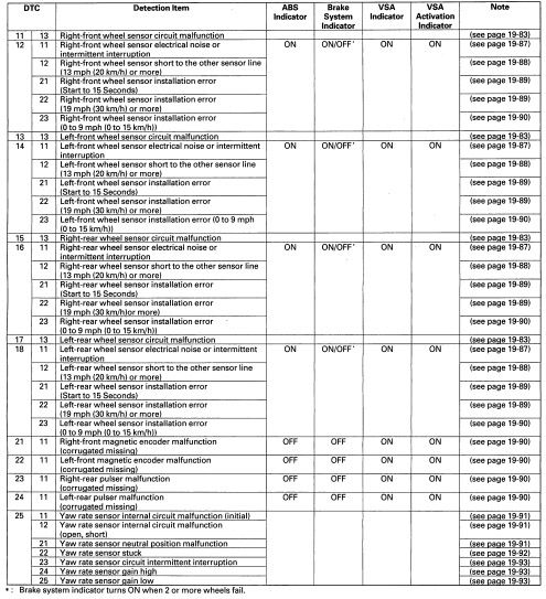

Incidentally the DTC codes I posted on the earlier topic don't completely work so I have refreshed the images and also reproduced below.
