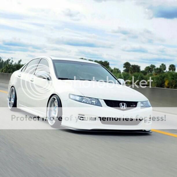

And here I was thinking I'd be able to get a bumper like this....
:rolleyes:
I had a look around the net for an aftermarket front bumper, but there don't seem to be any for the Accord. :D
