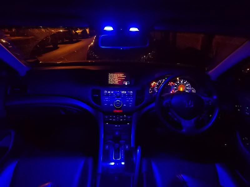

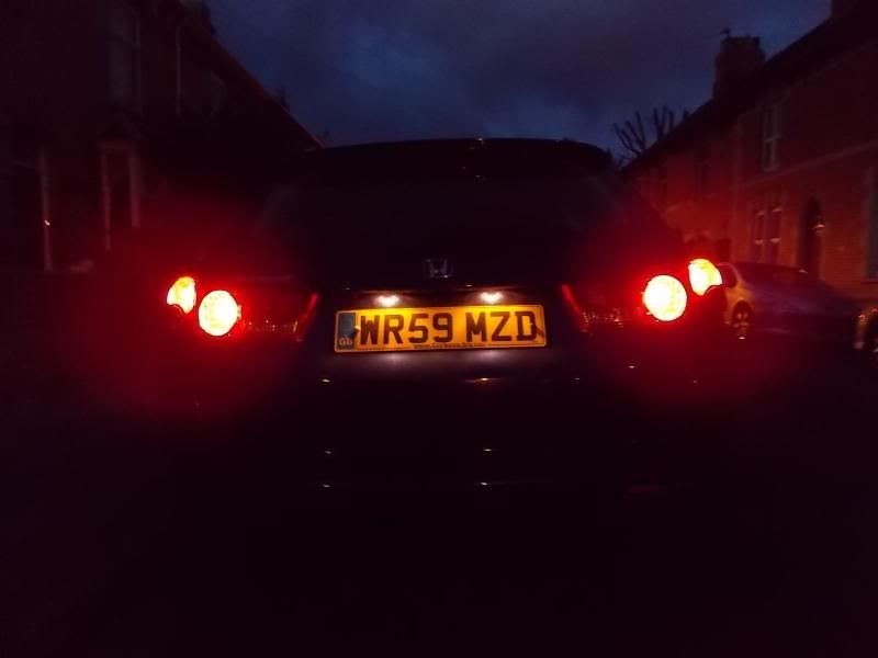

Interior bulb replacement done :D

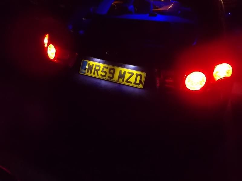

Blue LEDs inside, white LEDs on rear number plate.
I tried the number plate bulbs in the sidelights and they looked great so full 'white' front bulb replacement coming soon!!

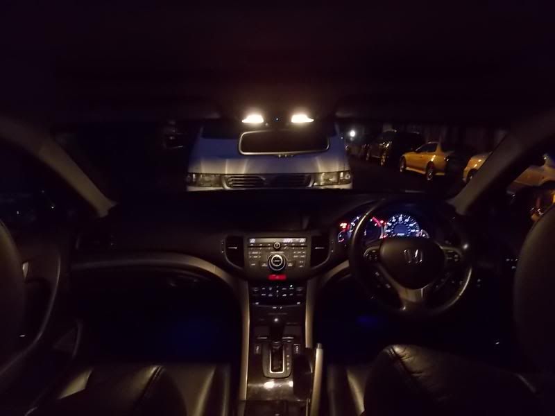

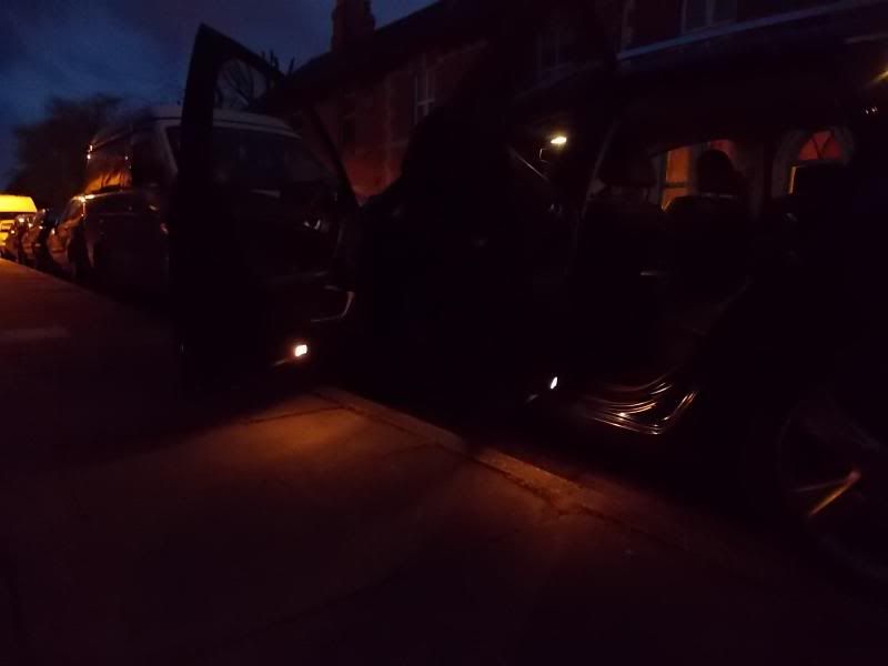

BEFORE

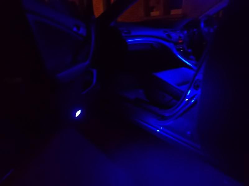

AFTER
Very nice. I think you should try this as well but in Blue.
I put a SMD LED strip along the bottom of the door and shoved the wires into the bulb holder of the door. For £4 I think its a great mod.
I still need to change the original bulb to a red LED which Ill order now :D
