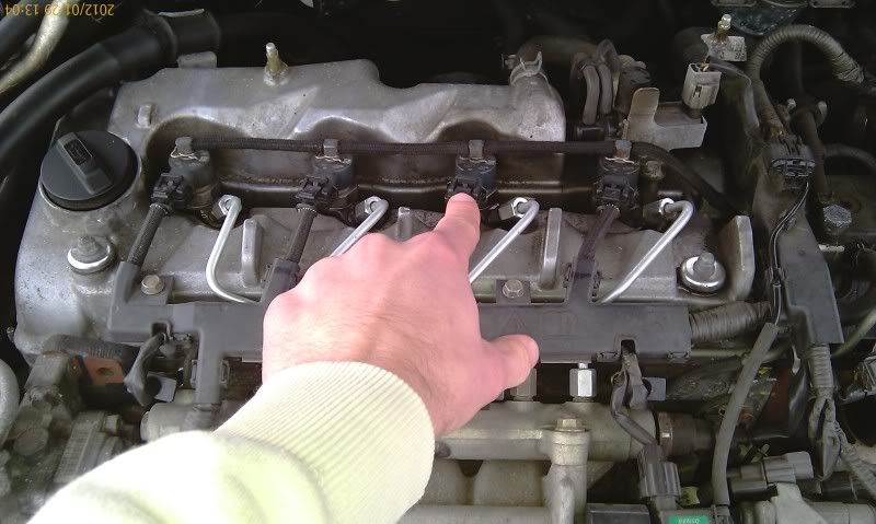

I am currently suffering with injector blowby.
this can be checked by removing the engine cover and checking around each injector.
My issue is this injector...
closer in......
You can easily see if its leaking or not as it will be 'wet' or sooty around the injector.

I notice you say yuo live in Hampshire ??
Where abouts ?
closer in......
