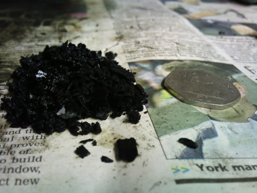

It's just two bolts and an electrical connector (maybe one pipe to the air intake, can't remember exactly), you shouldn't need a gasket, just give it all a liberal dose of cleaner and maybe a gentle dig around with a pipe cleaner and you'll be good to go. 30 / 45 mins max including tea break.
its only a couple of bolts......will probably look something like this when you take it off
Then clean it lol.............
Bolt back on...jobs a good un :p
Does the 1.8 have the plate on the inlet manifold like the type R?????
Needs cleaning as well so you end with a pile of this
