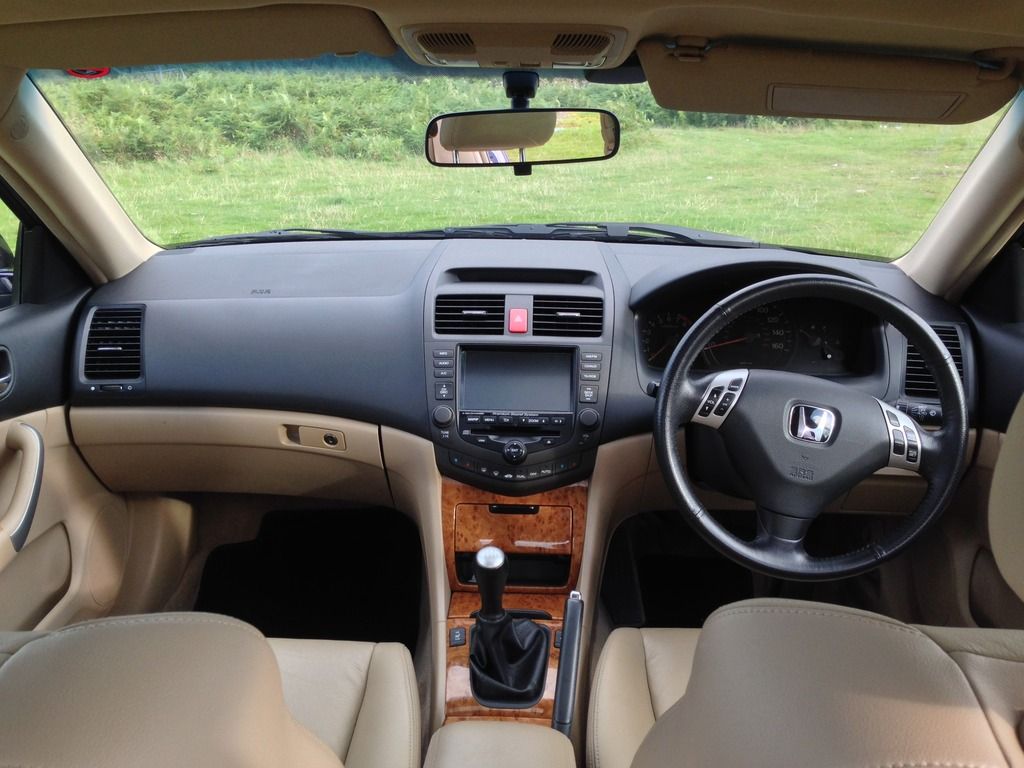

When it came to plugging the unit in, mine differed slightly from the Xcarlink (or my car is slightly different). This is what my dash looks like:

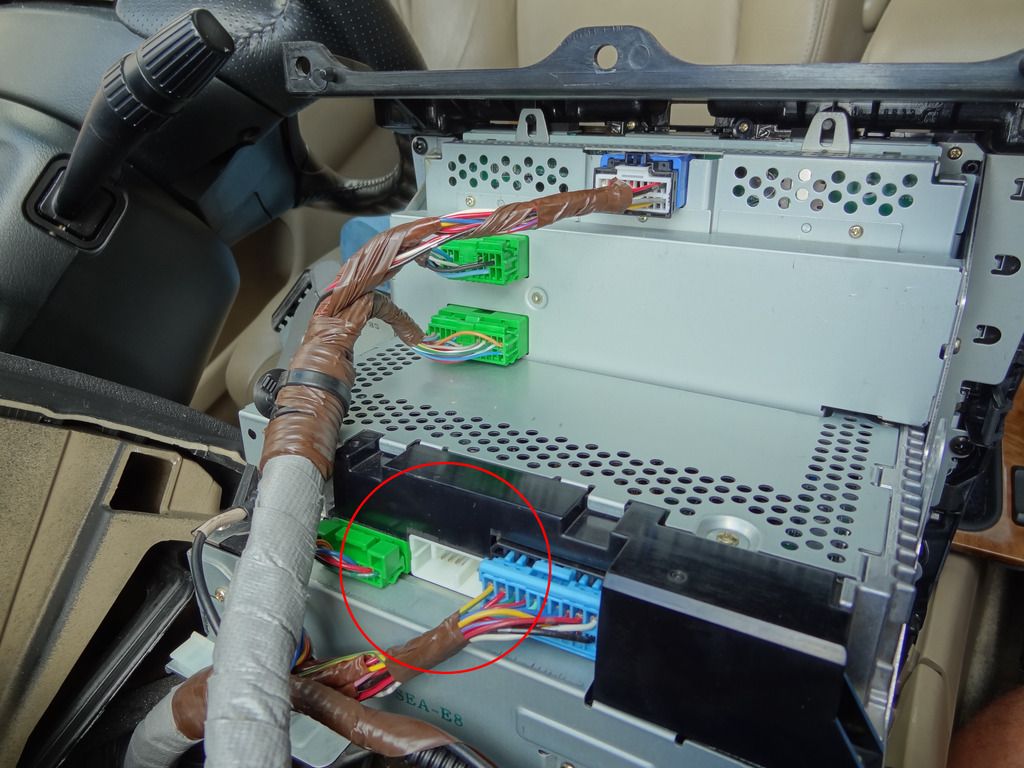

On the back of the nav / audio unit I had this one empty white plug so in it went:
If you already have a plug in that hole the cable supplied with the unit had an extra bit to receive it, so you won't lose any other inputs.

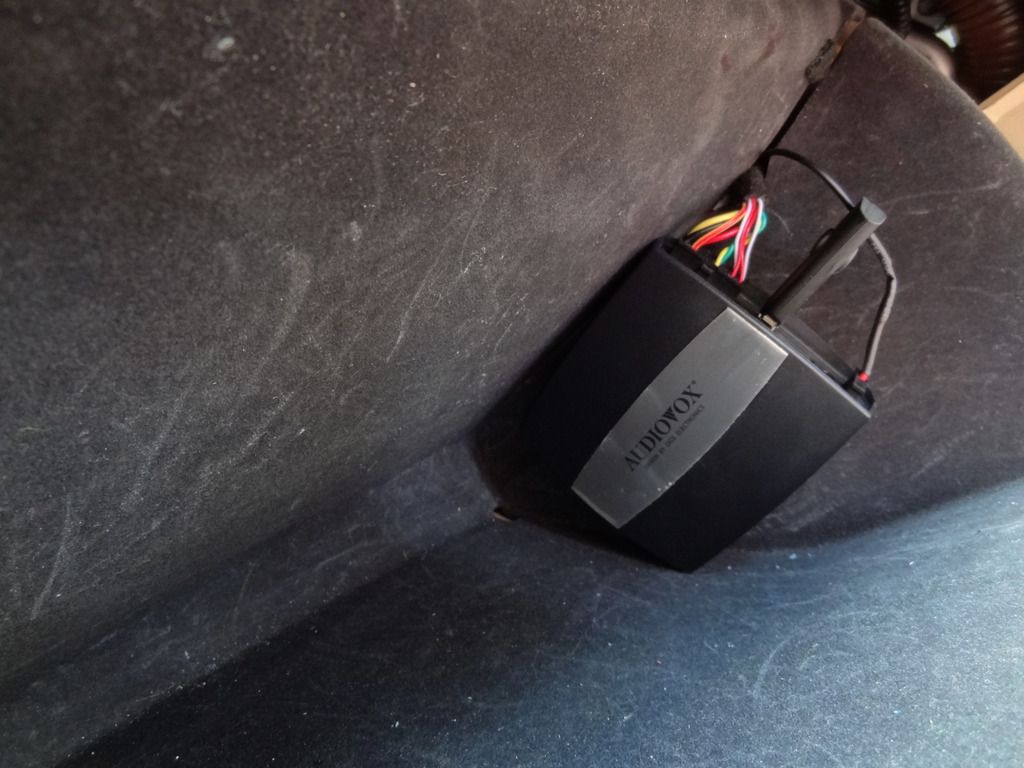

I put the little MediaBridge box in the glovebox, passing the cables down the slot that's already there. It was a bit tight so I opened up a gap at the base of that slot with a Stanley knife. Now it sits comfortably on the right of the box, easy to get at but out of the way:
